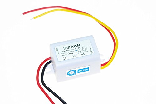

Maybe something like this would be more stable but I haven’t tried it, and after the buck converters failed I feel safer with the AA cell.
SMAKN® DC/DC Converter 12V Step Down to 3V/3A Power Supply Module https://www.amazon.com/dp/B00ODL140M/ref=cm_sw_r_cp_api_kEYTybVB70XMZ

If you’re leaving it in the car, or bike, why not a dc/dc step down with an inline fuse and hook it to the car battery? Then you could pretty much forget about it until you had to replace the battery
Because of this ^
Missed that. Sorry
No problem! It’s actually a really good idea and I’d like to try it out again. Maybe get a fixed rated DC/DC converter next time.
It’s in my cart, just haven’t pulled the trigger. Separate batteries seem safer after my battery drained.
