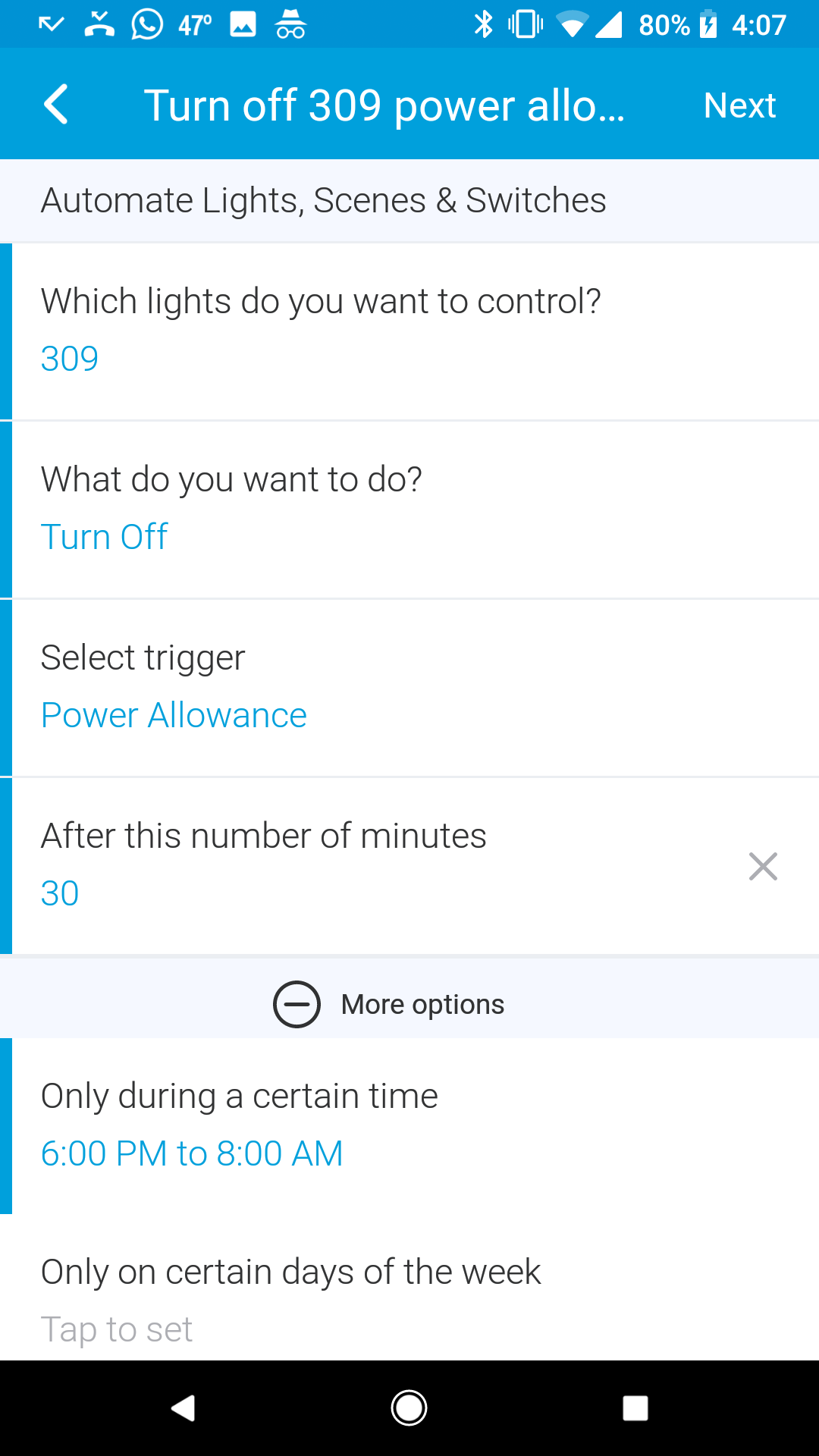

How would I set a Daikin Split unit using Daikins wireless interface to auto turn off after 6pm and if someone turns it on between hours 6PM to 8AM it should turn off after 30 minutes?
Something like power allowance I did with the lights.

If thermostat is set to cool (or heat) before 6pm, you might be able to use smartlighting to turn it off at 6pm if the thermostat supports the capability “switch.” Smart lighting is intended to work with light/fan/appliance switches and bulbs, but there are several kinds of device handlers that can use that capability to work with smart lighting.
If the switch capability really does work, maybe the power allowance does too.
