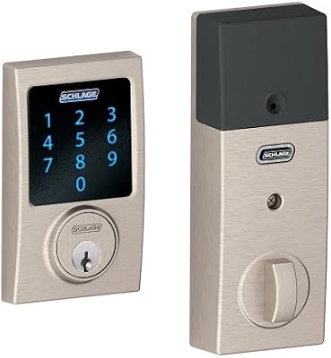

My lock:
I have this lock in the Camelot version. My only recommendation is to make sure the bolt slides very easily. You’ll eat batteries if you don’t as it will shift into high power mode to try and make the bolt slide.
