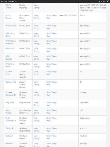

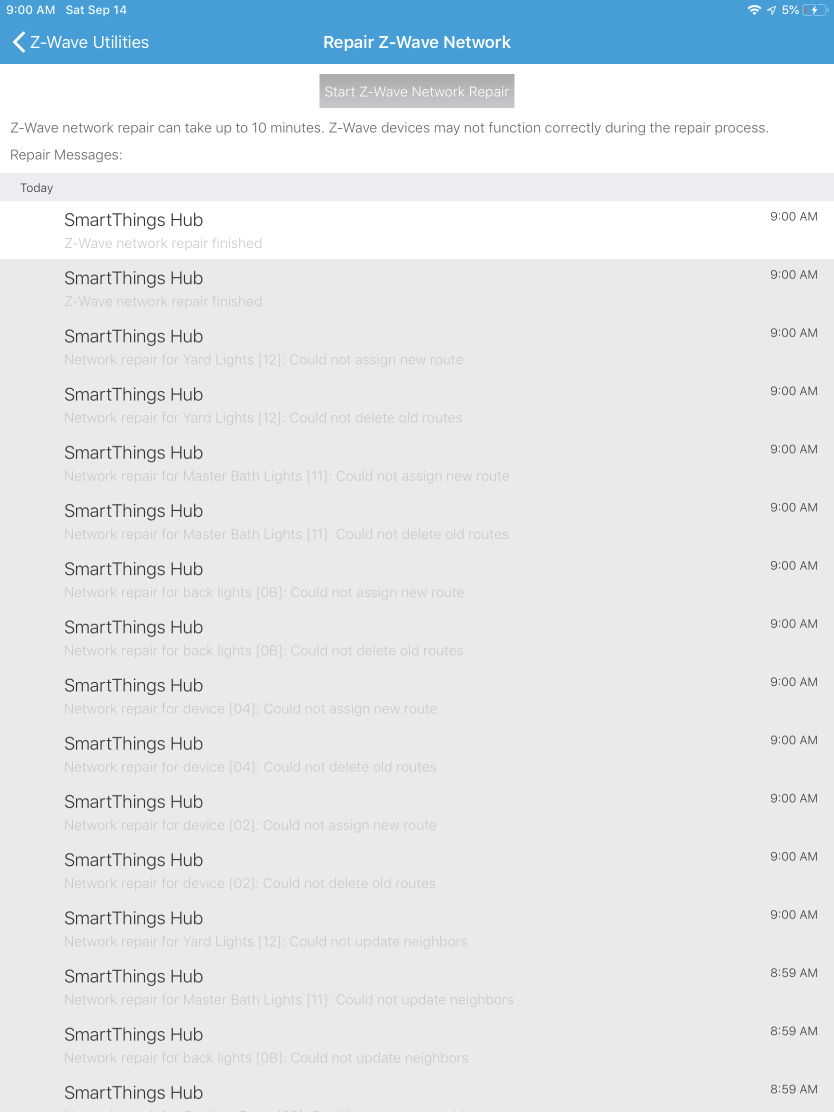

I am trying to run a Zwave repair on my SmartThings WiFi hub and the repair report is showing devices that I don’t even have in the API device list.
Also, when I do run a repair, none of the current device are able to find any new neighbors. Nobody at tier 1 support can answer the question as to why this is.

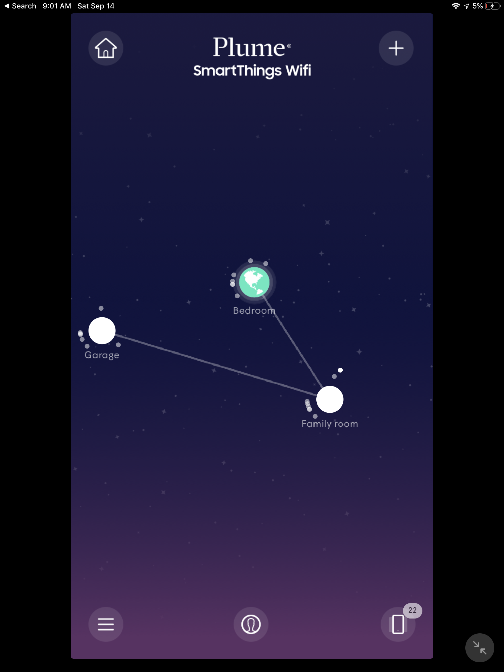

I am also not able to determine if any of my satellite hubs are acting as Zwave repeaters. There has to be a way to determine if my 2 satellite hubs are functioning as repeaters.
I don’t have an answer to your questions, but I can confirm that there is definitely a need for sub hub z-wave signal measuring. These are fantastic devices for a fraction of the cost of a more well known mesh wifi system, but are lacking in development.
As far as Z-Wave network repairs, I’ve been running them on dozens and dozens of different mesh hubs and I never get feedback in logs regarding remapping of neighbors. I do however get improvements after repairs so I’m assuming it is doing this and just not reporting it. I also have the issue of ghost devices appearing in the repair but I can’t find them in the IDE.
The lack of the ability to see the satellite hub zwave repeater’s performance is ridiculous.
I see the ghost devices in the classic app zwave repair report but there is no generated report In the new app.
