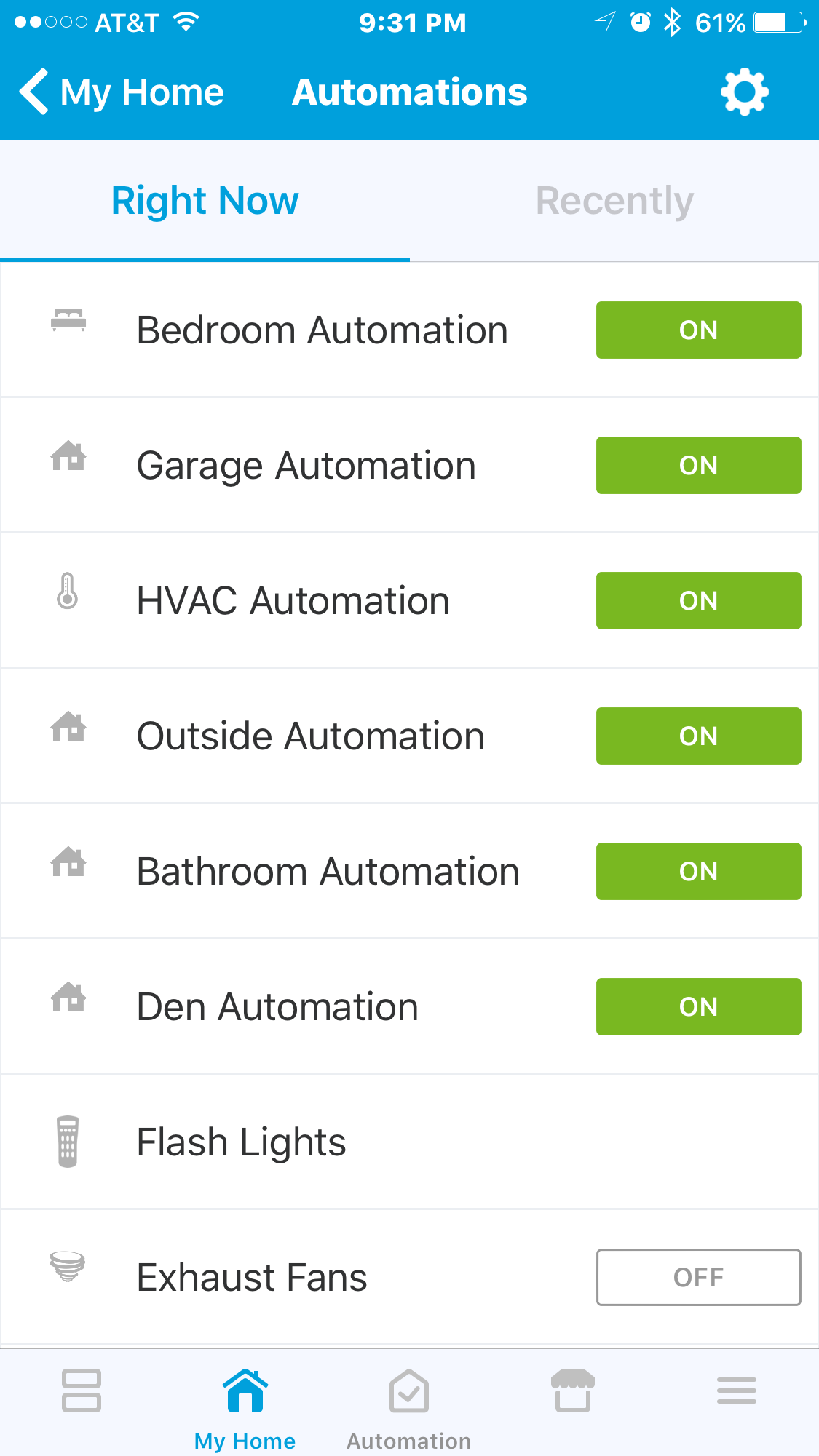

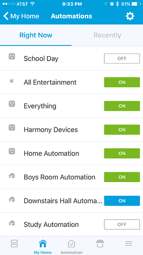

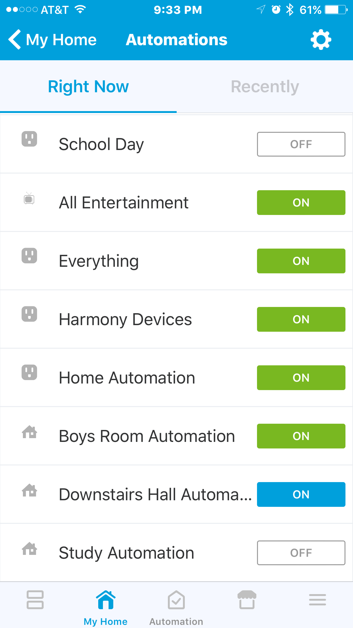

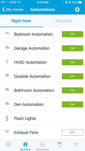

So here’s what I do. I have a Virtual Switch for all of my rooms that is simply titled, “That Room” Automation.
I build my rules with the restriction that "That “Room” Automation Switch must be on.
If I want to bypass a rule, I simply turn the Virtual Switch off.
For easy keeping, I put all of these switches in a Room.
