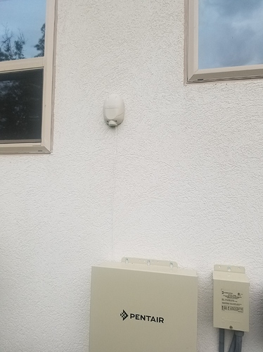

Where do i connect the usb device? I tried the back of the computer running the software and that does bot work. Someone here said Pentair main panel. Can someone post a photo or something?
You need to run a wire from the Pentair control panel to the RS-485 device. If you have the Screenlogic protocol Adapter, this is the same wire and you can potentially extend it or run a new one alongside it to the panel. This goes onto the Comm connector blocks inside the pentair panel.

will RS-485 device work if I’m connecting it to the wireless ScreenLogic2 interface? (there is no physical cable going to the main Pentair panel)?
sorry I don’t know about that I’m not sure what the wireless screen logic interface is. But in general I would think no as rs-485 is a physical interface.
This one:
The white box in the background is an rs485 interface. So if that’s hooked up to the larger wireless interface in the front you might have something. basically the rs-485 adapter on the raspberry pi connect to those same four wires.
I thought so. I think they replaced the direct wires to Pentair box with that wireless/radio device. I will try to connect rs485-usb to those wires > a laptop and see if it works(I want to keep the current ScreenLogic app too)
And this is the wireless device next to main pentair box
Should work in theory with both rs-486 devices connected to them since it’s a serial bus.
Will check in 1 week after I’m back from vacation and update this topic (in case others are interested)
