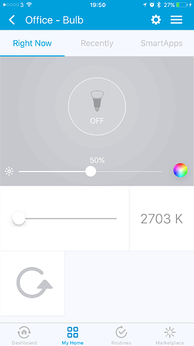

this is the ZLL RGBW Bulb which my Osram chose now …
the others still use the Zigbee Hue Bulb, I have just re-assigned one and it works perfectly - I got the RGB lights though - no whites but maybe worth a try mate …
go to the bulb in the IDE / my devices / select the bulb / edit and change the type to your desired profile …
the Kelvin picker is actually quite nice …
