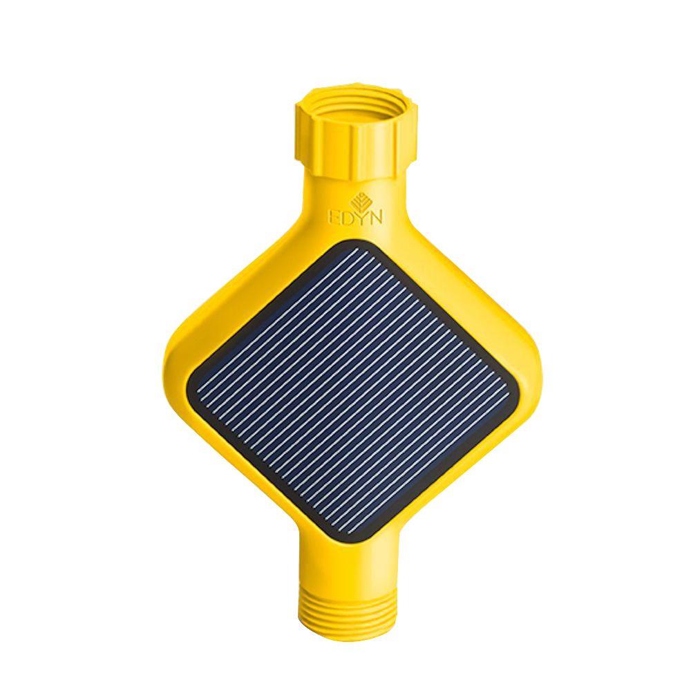

Looks like the Edyn water valve is finally for sale. $69 according to the article, but $59 at Home Depot.
Ships in 2-3 weeks. HD is out of stock :frowning:
