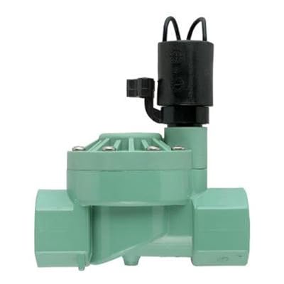

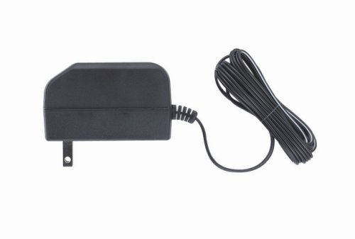

Here are the links. I’m going to screw the valve into my water spigot and then drill a small hole into my house so I can feed the wire through. Then use ST for on/off or timer. I would eventually like to have a smart app to read my Plantlink sensor and activate a zwave switch but I’m going to have to get some help from someone out here with that.

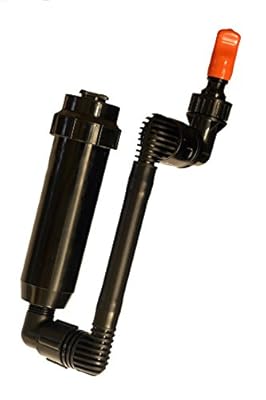

I use these in ground spay heads and they work great!

I just purchased the valve and power supply.

My only concern is that I don’t think the power supply is water proof.

Does it plug directly in to the valve? Or do we have to strip the ends of the power supply and connect to the valve?
The ends of the power supply are cut so you can strip them.
