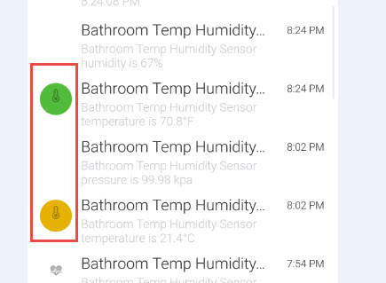

Hi @a4refillpad ,
I updated my preference in Temperature from C to F, the background color of the tile didn’t looks the same. Is there a reason why they are different? I think the green color for F is more appropriate than the yellow color for C.

Tom,
The colour reflects the actual temperature, the colour changes with the temperature, or at least it is most probably written this way but I cannot check at the moment to confirm.
You can amend the DH to your liking. At the top of the DH Code you will see where the settings are for the change in colour. As these are static values and you have changed the ‘unit’ it will most probably not be reflected correctly. You can edit the DH and change the values to suit your preferences. Have a play around but let me know if you get stuck.
I think changing setting from and to C & F should not change the color. Wondering if there’s a bug in the conversion because I only found background color in F in the DH.

The values are hard coded as I mentioned.
So it is still looking at the colour code for the actual NUMERICAL value, it is not differentiating between Centigrade/Celsius and Fahrenheit. You can edit the DH to have 2 separate sections I believe but been a long time since I played. Have a look at a few other DH’s that use temp colours, they may help you.
