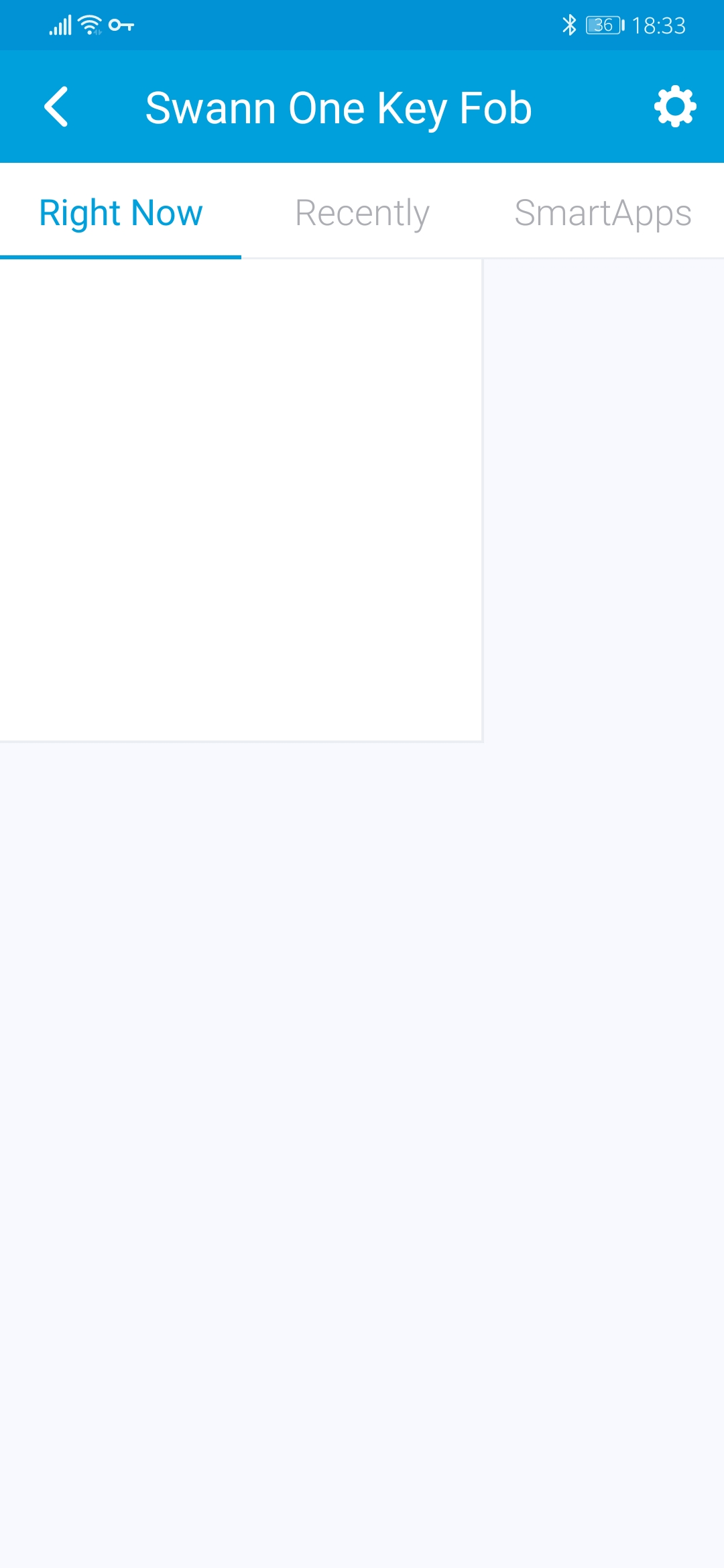

Hi,
I have a problem with my key fob, not being fully recognized by my v3 app.
I fact, only one button shows up in settings (see picture).
What can I do?
Please help me out, I’d be so
You are using the wrong App. You have to use the SmartThings Classic App.

But, as a matter of fact, the image that I get from the classic app is similar…
No buttons at all to choose from.
What am I doing wrong?
You’re doing fine. It’s supposed to show nothing, since there’s no icon for it. If you click the “gear” icon, you can update icon to whatever you want, even your own picture. If you select the “Recently” tab, and quickly double-press one of the buttons, you should see the activity. If so, you are good to go.
Obviously I’m doing something wrong. That’s because, as you can see in the screenshot, I cannot change the icon the way you described I could (something I can indeed do with other devices).

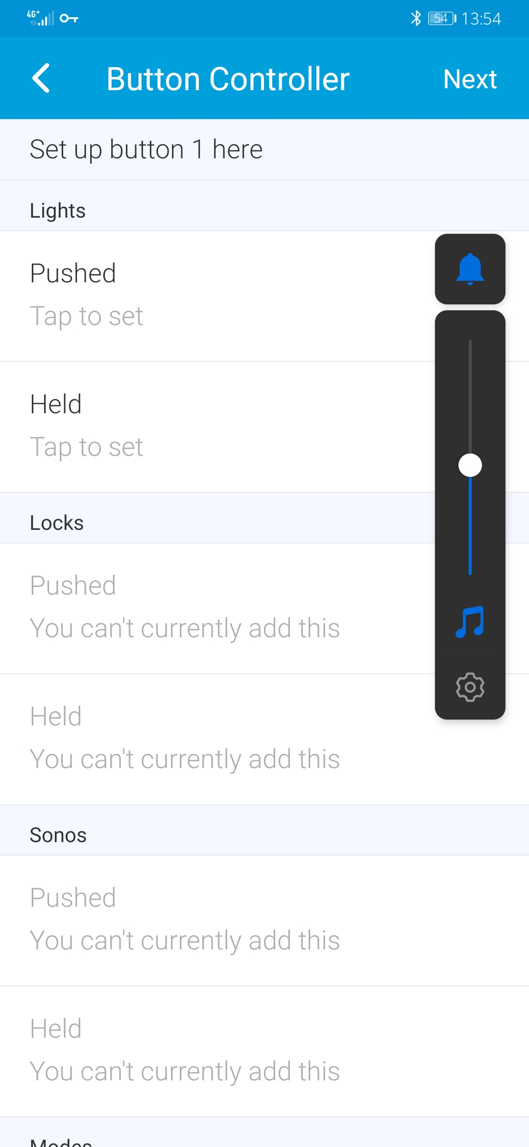

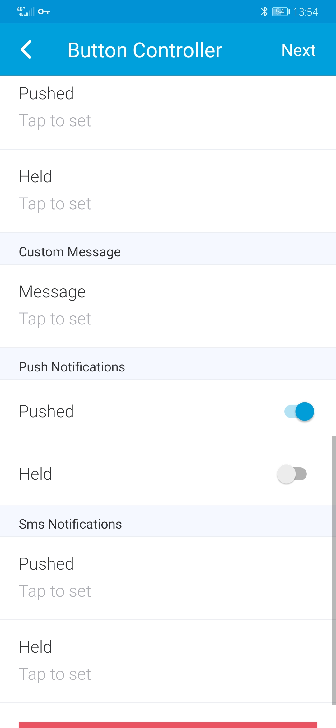

And then, in the “recents” tab, I can see each “button pressed” event. But how can I set these buttons to control my Home Monitor status?
Maybe with button controller smart app? There’s also no choice for that there…
Once again, thank you very much for your support, I appreciate it very much.
