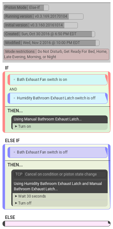

I have no problems with much of anything. I only have 5 zigbee bulbs. The other 50 or so devices are z-wave. 3 of the bulbs, ge, are within 15ft of my hub and the other 2, cree, are probably 40+ feet away. My z-Wave mesh is strong. Zigbee, not so much so I’m surprised I don’t have issues. I have had only a couple occasions where the Cree have acted up but I left them alone, they always fix themselves in a day or so. Any issue is very rare though. I have had great luck with the v1 hub so am scared when I read the issues with the v2. I guess I’ll see what things look like when I set up the new place down South. Anyway, here are the pistons.
This piston stores the current humidity level in the bathroom in a global variable if the door is open and the fan is not on removing humidity. I have a sensor on the door. It works great for making due the light stays on too without having to try and find showers, etc.
This one turns on the fan if humidity is high, 5% above setpoint. It will turn it off if we are close to the living room humidity level, or if the house needs More humidity or it times out at 60 minutes.
This one is used if my wife is cleaning the bathroom and uses the fan to exhaust the fumes. It ignores humidity and will run for 60min if not turned back off manually.
Make sure to click on the pictures. A couple of the pistons are longer than what is showing.
