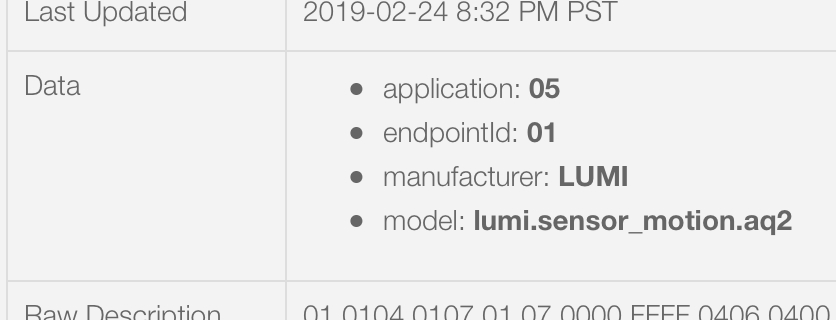

Okay, let’s start over. A few questions so I can even begin to help:
  • What’s the model of the motion sensor? There are two models, so that’s important to know.
  • Which DTH code did you add to your hub’s Groovy IDE?
  • To check whether it paired properly, can you post a screenshot from the motion sensor’s device details page in the IDE? Log into IDE, click on My Devices at the top, then click on the name of the motion sensor (in the “Display Name” column), and then look for the section row labeled “Data:”. Here’s what it looks like for one of my Aqara Motion Sensors:
  • In that same device details page, you should also see information in the “Current States” section row. A screenshot of that could be helpful.
  • Finally, in the SmartThings Classic mobile app (not the new “Samsung Connect” mobile app), change to the “My Home” tab, select your motion sensor to view it, and press the “Reset Motion” app tile. Next in IDE, click on Live Logging and then walk in front of the motion sensor to activate the motion detected message. Do you see any log output from the motion sensor? If yes, please copy and paste it in a post here.
Thank you.
Thanks. Ok ive removed and and im now trying to re pair it again. not easy.
After i do that i’ll check back in ( if i ever re pair it again ) :slight_smile:
Managed to sort it out mate. Thanks alot though
