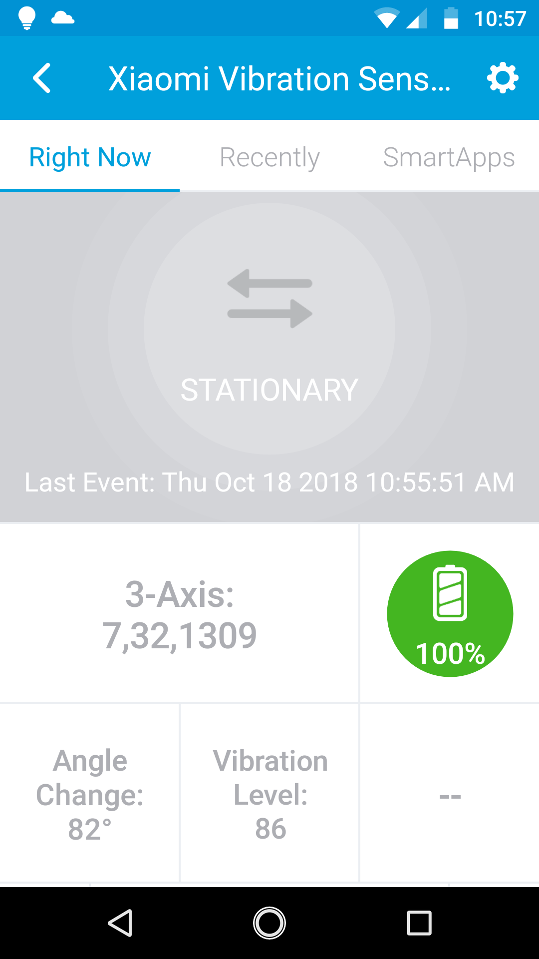

I should probably rename that value to “Activity Level” because from all of my extensive testing it does not directly correlate to vibration level. I wrote a rather long post here about my findings, but I’ll repeat the important bits again here:
Here are the values I saw on one of the sensors over a period of 12 hours:
Example attribute 0x0505 (“Vibration Level”) values observed
(click arrow to reveal list)

Some observations about the “Vibration Level” reports / values:
The time intervals between reports are inconsistent, but the most frequent intervals I see are about 5 minutes apart.
The values seem to represent past levels of vibration or activity, and not what is happening currently
The lowest value I’ve seen is 1 and highest is 265.
There seems to be some correlation between the number of vibration, tilt, and drop events and the “Vibration Level” value, but I think it’s not solely related to those events, especially since some events seems to prevent others from being reported when moving the sensor around a lot.
The values reported do not seem well suited to use for sleep movement detection, unless the sensitivity level has some effect, just based on leaving it under my pillow while sleeping and observing long periods without any reported values.
So I am definitely NOT planning to allow use of the “Vibration Level” (as it’s called now) for any home automation purposes in the DTH.
This is because the vibration event message works differently from the “Vibration Level” reports. As explained above, my findings show pretty clearly that the “Vibration Level” is reported after the fact, the timing and intervals of the reports are inconsistent, and the values do not correlate 100% to actual vibration levels. So I feel pretty sure that it cannot be properly used to generate motion - active events in SmartThings.
On the other hand, the vibration event message is sent from the sensor as soon as vibration or a shock is detected. So this can be used to generate a motion - active event in SmartThings. As long as the vibration continues, the sensor will send vibration event messages at roughly 60 second intervals. But the sensor does not send a message when it stops vibrating.
This is why I put the default 65 second timer to reset back to Stationary (which sends a motion - inactive event to the SmartThings hub.) If the sensor sends subsequent vibration detected messages, the 65 second timer starts over, and from the SmartThings hub’s point of view, the sensor remains in the motion - active state. 65 seconds after the last vibration detected message we can safely assume the vibration is over, and the state changes to motion - inactive.
So, @MABeatty1978, to answer your question about the washing machine use case, you’ll want to base it on the Motion ability of the sensor when setting up a SmartApp automation. I don’t know what SmartApp you’re using, so I can’t really comment on how that could be set up. Perhaps to only send a notification when the sensors motion state changes to inactive?

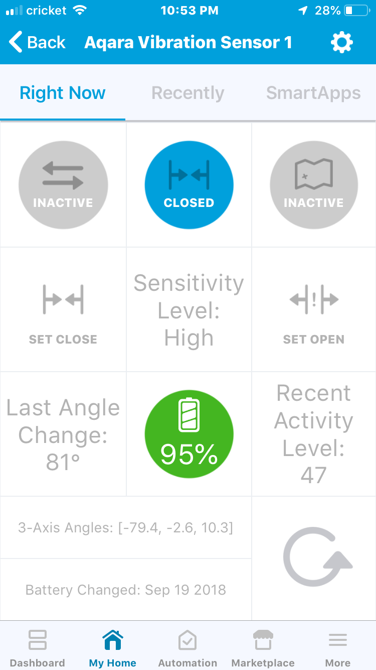

This version finally adds a open/close capability to the DTH, using code graciously shared by GitHub user @_Oltman. His code calculates the angle position of the sensor based on its XYZ accelerometer reports, and allows the user to set and store open/close positions that are then linked to SmartThings contact sensor capability, with open and closed states.
Added NEW FEATURE: Open/Close position, which links to the Contact Sensor capability. Using code kindly shared by GitHub user @_Oltman, custom open and close positions can be stored by pressing the Set Open and Set Closed UI tile buttons while the sensor is in your desired open & closed positions. Once set, the DTH will generate contact - open and contact - closed events when the sensor is in nearly the same positions.
Added two new UI tiles to display current Motion (vibration) and Acceleration (tilt) states
Changed “Vibration Level” UI tile to more representative name “Recent Activity Level”
Removed icon displayed in main sensor status tile
Added “refresh” tile that can be used to initialize blank UI tiles if needed
Changed the 3-Axis tile to display the calculated position angles instead of the raw accelerometer values
Reorganized UI tiles
Changed the method to initially set and display hardware Sensitivity level when the sensor is paired (If the sensor is already installed, either press the new “refresh” tile (bottom right) or open preferences and press “save” to set up the Sensitivity level UI button
Added code to initialize Recent Activity Level and Last Angle Change UI tiles to display “–” if no reported values have been received yet when the sensor is paired. If this doesn’t work, they can be manually initialized either by pressing the new “refresh” tile (bottom right) or opening preferences and pressing “save”
Improved the code that cycles through the 3 levels when Sensitivity level UI button is pushed
Fixed mapSensorEvent to correctly set a status reset timer of 2 seconds for Tilt or Drop events
Changed the timer reset code for Tilt/Drop events: If a Vibration/Shock event is followed by any Tilt or Drop events, the main UI tile will display “Tilt” or “Drop” for approximately 2 seconds, and then change back to display the “Vibration/Shock” status until the Vibration/Shock reset timer is finished (or until another different event occurs.)
Moved code to reset to Stationary status from updated() to configure() so that that status isn’t reset to Stationary when preference settings are saved, instead only resetting it when the sensor is first paired
Added info log messages to report open/close/unknown position
Added info log messages to report successfully set open/close positions
Various code cleanup/reorganization and formatting fixes
After updating to this new DTH code, I recommend opening preferences and pressing save. That should fix any issues that some users have been reporting about the Sensitivity Level UI button not working.
I still cannot confirm that the command to change the hardware sensitivity is working. On the SmartThings platform, no confirmation message is received from the sensor.
No contact - open or contact - closed events will be sent until both the open and closed positions are set. If the open and closed are set for the same position, then it that position will only report contact - closed.
Although not officially supported by the contact sensor capability, when the sensor is in any position outside the set open and closed positions, a contact - unknown event will be sent and the tile will display “unknown”.
The open/close position algorithm uses a margin of error value to allow for some variance from the stored open/closed positions set by the user. This is not user adjustable yet, but may be added to the preference settings in a future release.
