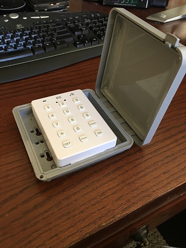

I bouth a centralite keypad on ebay but it didnt come with the wall mount. Can anybody post pictures of the wall mount please. I want to see what it looks like so I can maybe design and 3d print one
@JDRoberts saves the day, again. I’ve been using this one out in the open for couple of weeks now, no problems…
CentraLite Keypads - #290 by JDRoberts
Nice. I just got done with shaving down the inside of a 2 gang outdoor box. Only required 10 min of work with my Dremmel and $8.00
