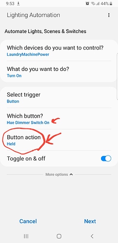

So I know have a request for a feature.
In the app, it shows whether the button was pushed or held.
But the held action does not seem to be available in smart lighting.
Can the held be available as another set of button actions?

I found where the held is listed when making a smart lighting rule! Thanks for the tip. I just missed it.
