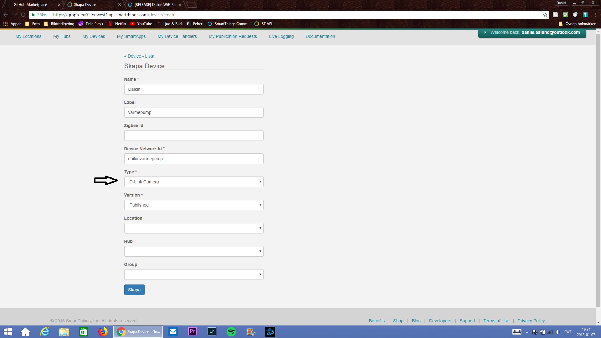

Mayby im dumb or just a noob, but i can´t find “Daikin Wifi split system” in the Type dropdown menu, is there anything else i can use in the dropdown?
Have you installed the Device handler correctly so it is published as well?
I´m creating the device now but in the device list there is no Daikin wifi split…I clicked on my devices - create new device. maybe im att the wrong place. Sorry for dumb questions but im really new to this.
This is much better now! Temperature is updated and visible in Daikin app with current mode. What I still don’t see is changes made through Daikin app or remote controller.
Now i understand why i can´t find it, i have to copy the device handler first of course :stuck_out_tongue:
It works! Awsome!

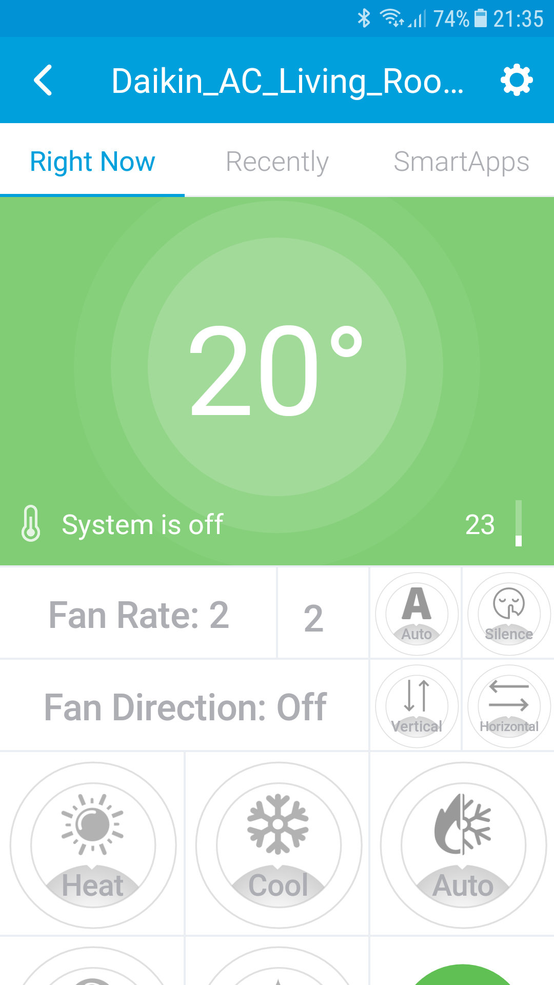

I have a question, my inside temp and outside temp seems to be stucked on 20 degrees. I have tried to update but it doesn´t change.
If I look in to the Daikin app the inside temp is 22 degrees and the outside temp is 0 degrees.

Screenshot_20180107-213526

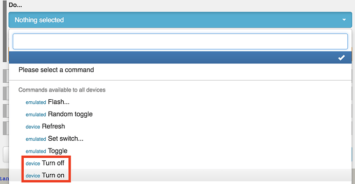

I have canged this piston and now using “Turn off”, so it works now. :slight_smile:
Hi Davor,
You need to use the Switch type on/off functions. onPhysical() and offPhysical() look like custom functions :slight_smile:
See below:
