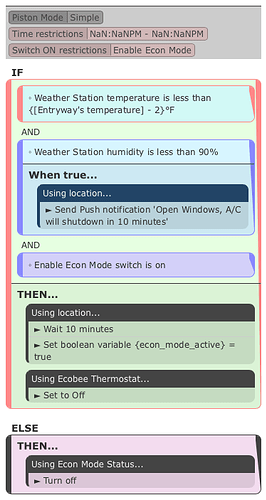

I’ve been following this forum for some time now and I have just successfully finished automating my Ecobee3 to trigger Sudo Economizer mode. It may be basic but it’s just the beginning :grinning:
I’m so excited how it turned out I had to share my enthusiasm for CoRE!

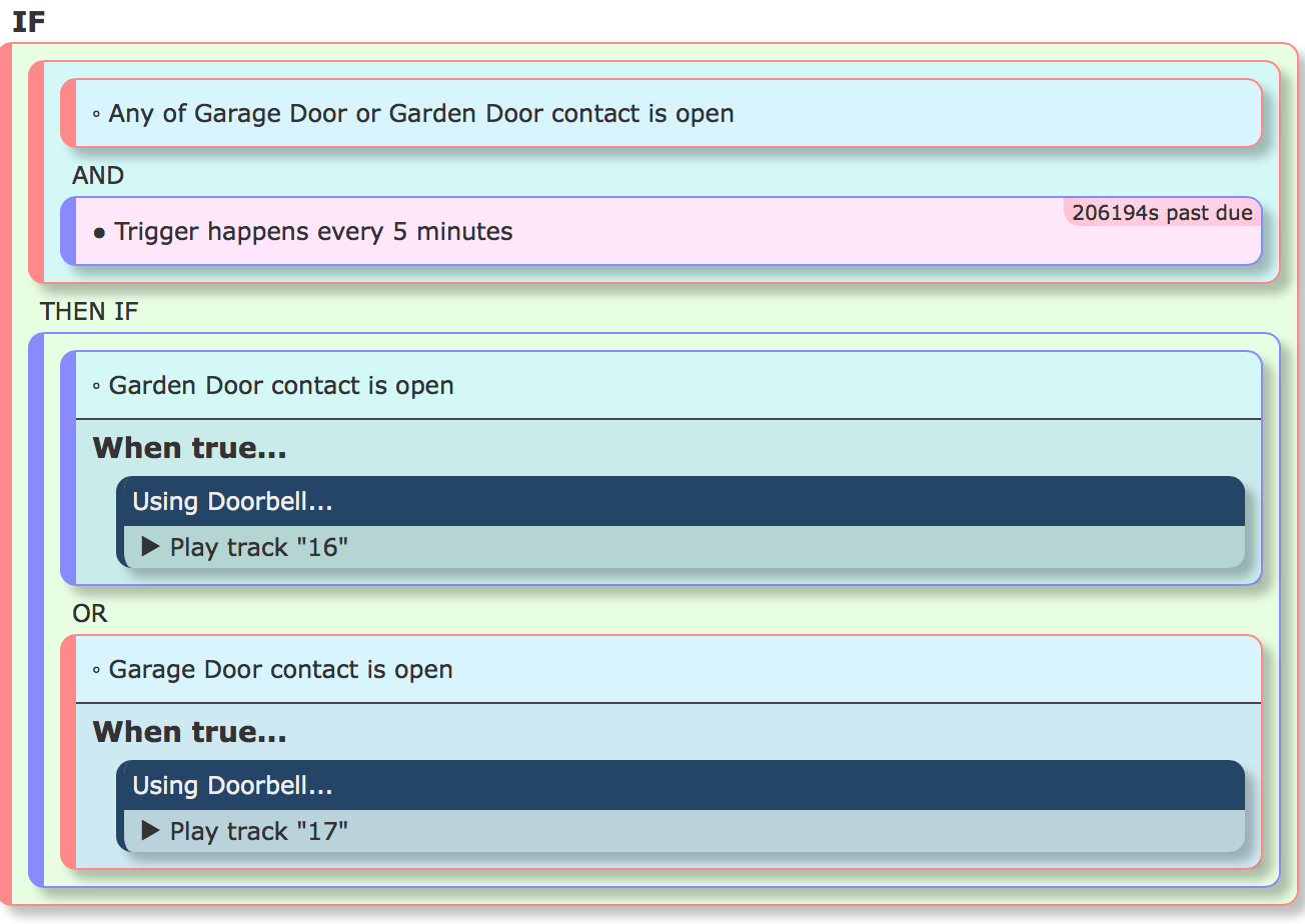

Beat you! I have 2 pistons that are 206194s late :triumph:
So if I understand this correctly this was an ST issue which with the new scheduler should not be happening?
In this case one piston is just time based but this one is a combination of contact sensor trigger and time, anything I can change in the piston so that this will not happen when ST misses a schedule?

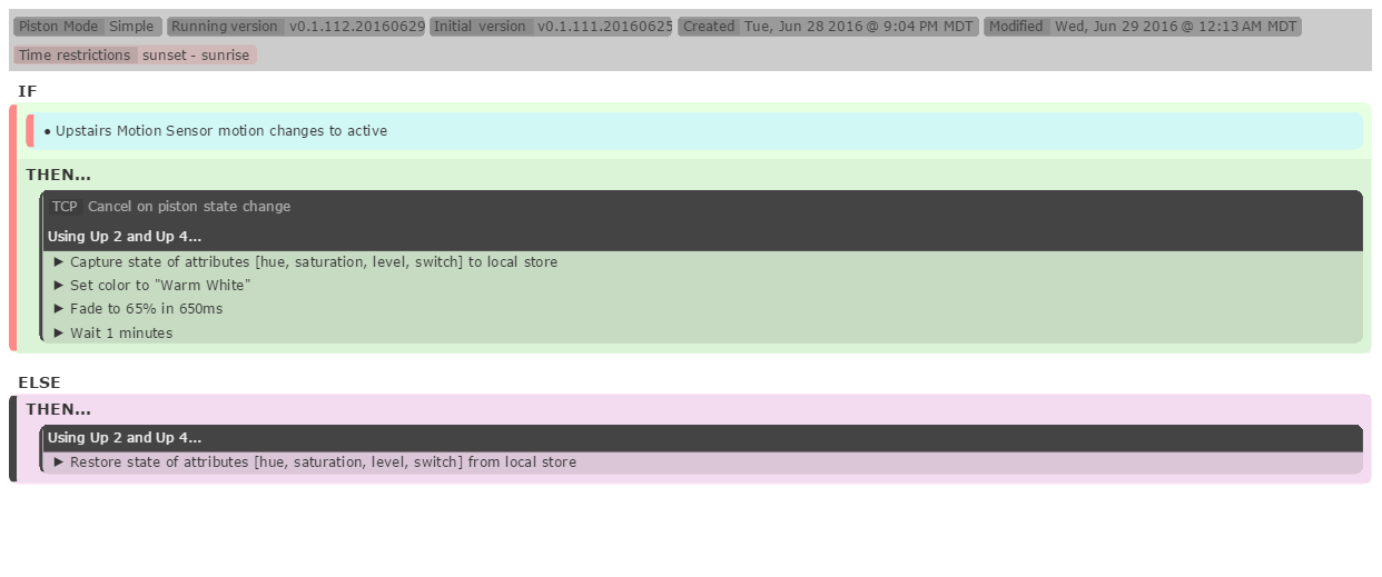

Use case: The intention of this piston is to increase the brightness level of stairwell lights when motion is detected either going up or down. The capture tool is needed because these lights will change color temperature throughout the night, evening, and late modes. This piston seems to do what I’m looking for, but wanted to get some community input on whether this piston could be written in better form. I also noticed that in the piston “restriction” I cannot define an offset such as “sunset -45” but only “sunset or sunrise” instead. Thanks for any help…
