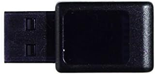

Last Friday I received Aeotec Z-Stick and update one of my sensor from 1.08 to 1.10.
Thanks to my co-worker who was visiting the US. :grin:
But it was still showing 1.10EU, I update the Device Handler and choose US! :wink:

I am behind the curve… I looked at the manufacture’s website, but it is not clear. Can the firmware be updated without having to spend another $44 on the stick, via USB directly? Is there another way to update these without the additional cost?

Yeah, unfortunately it only supports OTA updates so you have to have a USB Z-wave controller. There are some cheaper options:
