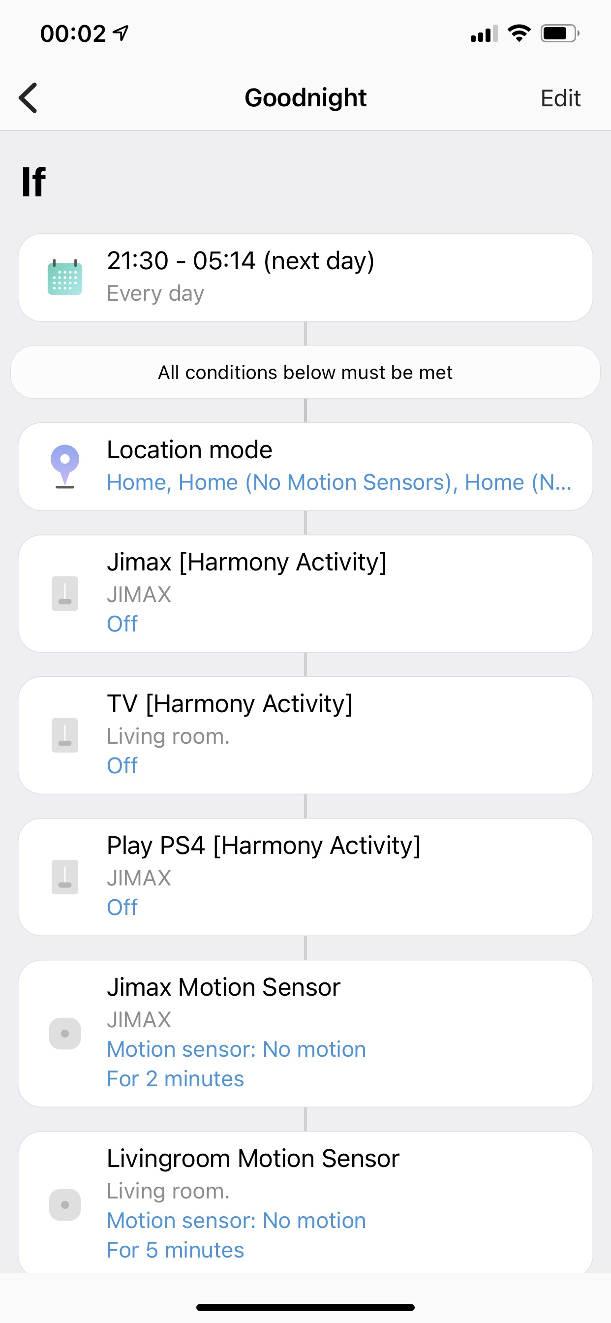

Can you post a screenshot of the automation based on your wife’s presence?

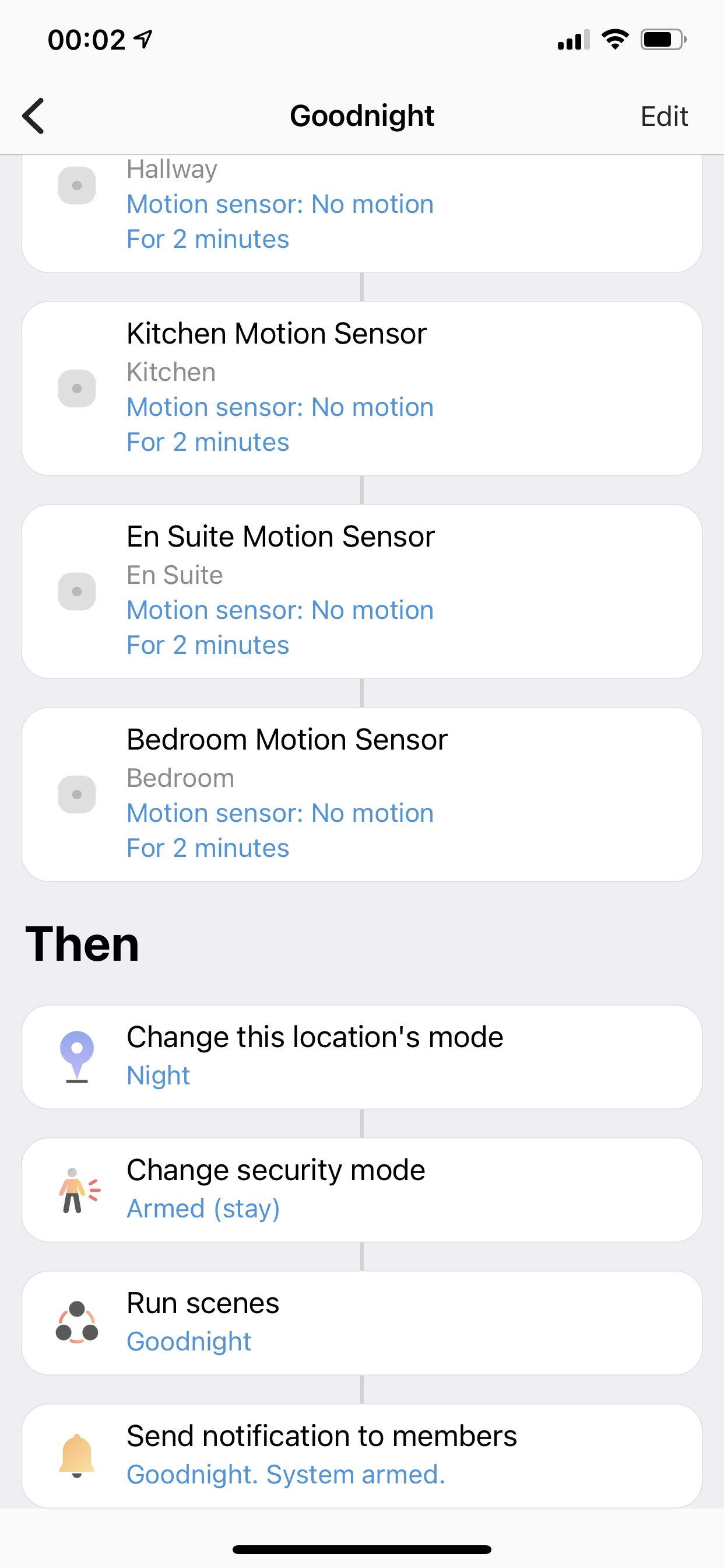

So this is my goodnight automation.
I’m not even sure if this is even correct.

I’d suggest editing the ā€˜Location mode’ condition and turning on ā€˜Precondition’ (hidden in ā€˜Advanced’). I think your problem is that your Automation is being triggered by your Location mode changing to ā€˜Home’ while the other conditions are still true and the change should prevent that happening.
One thing you are running into is that ST will act as soon as it sees whatever conditions it is set to look for. So even though you change the mode to Home, if the conditions are still the same as what triggers your automation, it will do so. So in your case, you can change it to home, but if the TV is off and it’s after 10, that will still trigger the original automation and set it back to away.

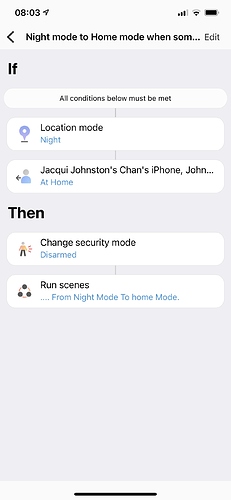

Here it is here.
Here’s my automation I tried to set up from switching out of night mode when someone arrives. Last night I don’t think it worked when I arrived, I’m not 100% sure though because I did get a notification that ā€œJJ is coming homeā€ but then a second later it switched back to night mode before I could even get to my driveway. Then I tried manually doing it from outside my house and it just kept switching to night mode again and armed stay.

It should do.
Your time range is itself a precondition. The automation will only run if the time range is valid. If it is then the piston runs whenever something happens that might make the conditions evaluate as true. So if the Location mode changes, or the state of any of your Harmony activities or motion sensors change, the automation runs to see if it needs to do anything. When the Location mode changes to Home the automation will run and check the conditions. The other conditions are still true so the actions run and the mode is flipped back to Night.
By making the Location mode a precondition you are saying ā€˜only allow this automation to run in this time range and if the Location mode is Home’. The automation can now only be triggered if something happens with the Harmony activities or motion sensors.
Your later automation isn’t a fix as it too is triggered by the mode change. It would disarm your system whenever you switch to night mode and you are both at home.
