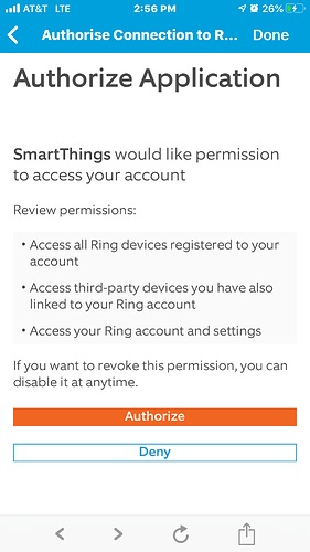

First thing is to get familiar with enablIng (installing) all of the Apps and Authorizations. Ring devices can be added which will expose the motion events to SmartThings.
