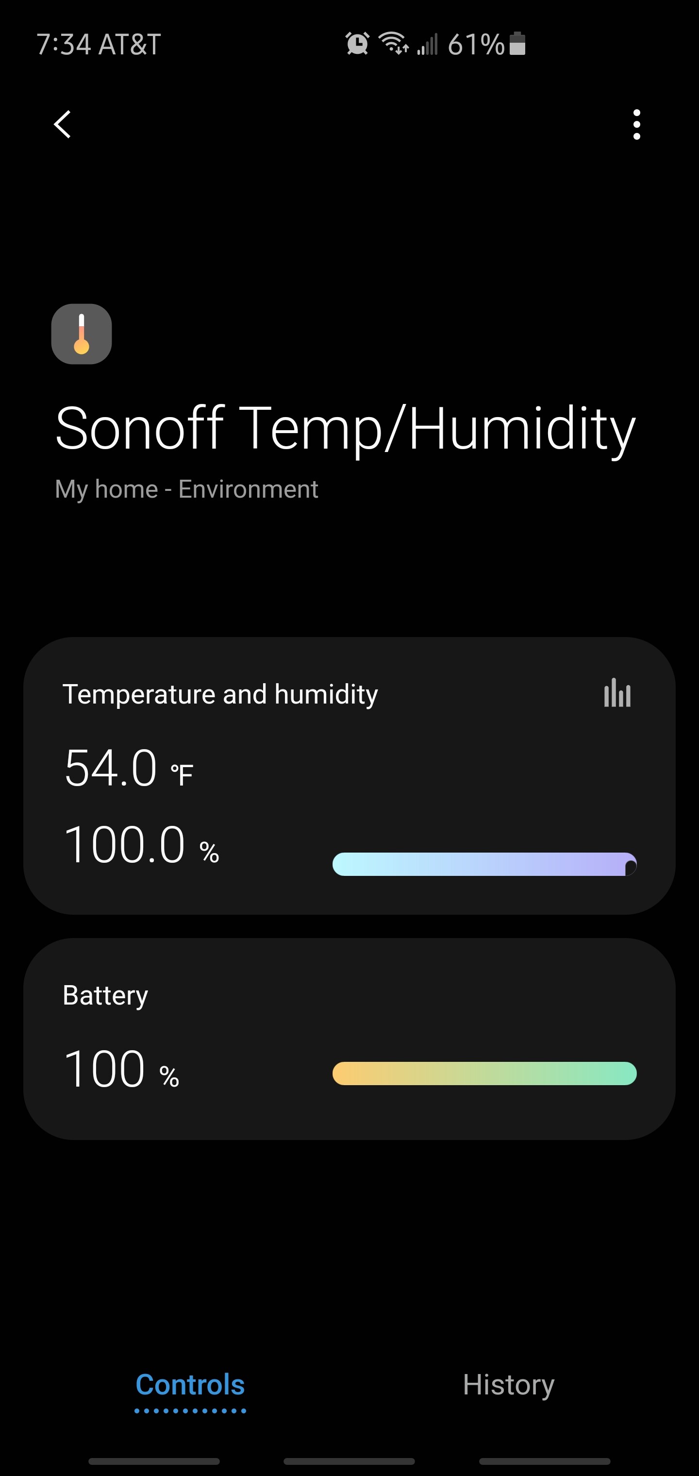

How do you get it to show in F mine only shows in C?
I added one SNZB-02 like “SmartSense Temp/Humidity Sensor” …
It works but while the humidity changes quickly the temperature is very very slow to update (~ 60 min)
