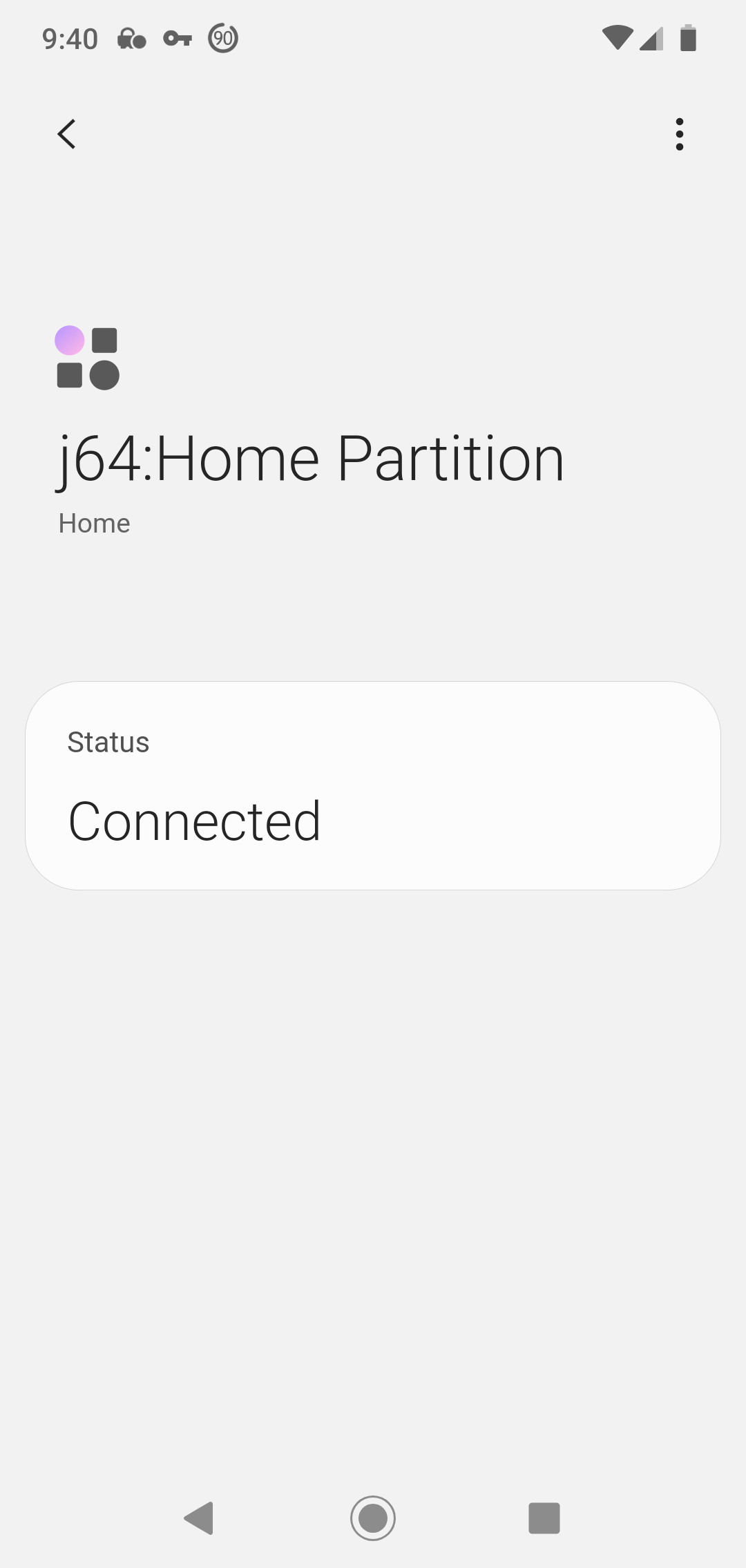

I was just forced to upgrade from the classic Smarthings app to the new Smartthings app. The process migrated my settings and Smartapps, but after the migration the alarm device no longer allows me to arm or disarm which renders it useless in the new app.
Im using AlarmServer as well (xxero’s branch) and it works fine. Although I dont use the device GUI to arm and disarm.
So what exactly do you mean by wont allow you to arm (screenshots are helpful because ghat could mean a lot of things and i need to know exactly what you need it to do.). Also you can use classic and new simultaneously so a screenshot of yoir old process would be helpful as well.
