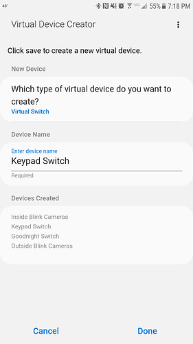

Nice article @dare2smile. You can also create a virtual device via the Virtual Device Creator smartapp built by SmartThings. No IDE or coding required! Right now you need the Classic app to install it, but after that the new app can easily use it to create devices without having to use the IDE at all.
To find this little gem, go to the Marketplace in Classic, then SmartApps, and then finally Virtual Device Creator. It remembers all the ones you created, which will go away when/if you delete the device in any of the usual ways. To create a new virtual switch/dimmer, just enter a device name and then tap on Done:
Oh yeah, and the virtual device created this way is local to your hub, not cloud based!
Really like the virtual switch creator, but at the present time in order to trigger an Alexa routine, you have to have a sensor. Not just a switch. So both the community FAQ and the blog article linked to have code for a virtual device which is both a sensor and a switch. That allows you to turn it on and off, but Alexa will see it as a sensor opening and closing.
I may be wrong, but I don’t think the virtual switch creator creates one of that type at this time.
Correct. Just set this up last night and needed the IDE to have a switch also be a contact sensor.
