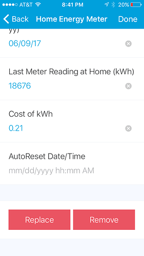

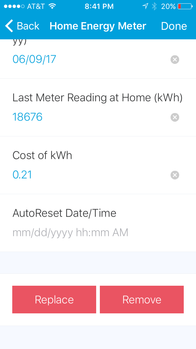

Above are my settings, would you mind looking at them and let me know if you see anything that is set wrong?
Thanks!
Which DTH are you using? Doesn’t look anything like what I see when I set up mine. I am using the Aeon HEMv2+, originally written by Barry A. Burke. I have made only one slight modification because for some reason it would not reset the total kwh as it was.
