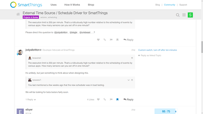

I also experience this issue regularly with my temperature sensors. I’m not actually sure if there is a solution… other than to write a custom service which can do the polling re-present the data via REST, and get the smartapp to subscribe…
I know it was mentioned more times, but this was the first one I could find. Please note that the Fairly soon comment was 28 days ago… i’m sure that it will be here … “in a few weeks” (via ST time of course) =P
