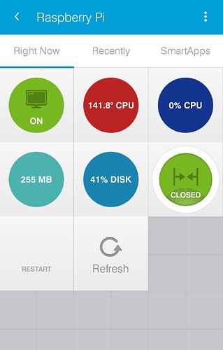

Hi, Just wanted to ask if the instructions cover absolutely everything that I need to do, there is little information on the BerryIO install, i noticed that there is bits and bobs in the other post mixed up within the other method, I have a Pi2 Model B so opted for BerryIO from the offset, followed the instructions step by step 3 times and still only getting grey tiles, I keep reading of things relating to API links etc but the two systems seems to have moulded into one.
I followed the instructions to the book and this is what I am getting in the log. any help would be great. Cheers.

I have it all configured correct but it shows pi is off and will not show temperatures or let me control gpio.
I know it connects because the reboot button works.

After many re-installs, the app only shows blank buttons and only restarts the rbp,
can anyone help?
Same problem here.
