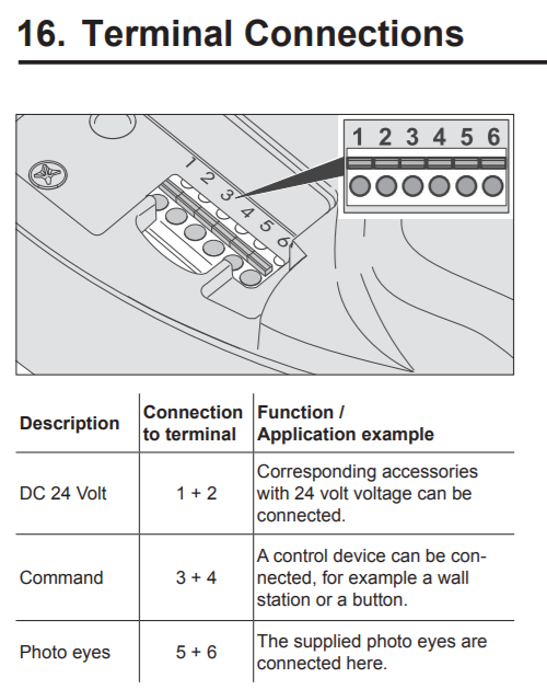

Daniel, do you have the Sommer opener integrated with ST? If so what device is controlling it? I have a relay hooked up to my existing opener since it just has a doorbell style button and curious if that would work for this opener. Based on reading the manual I suspect that won’t work give the wall controller has several buttons using two wires back to the opener.
I do, for two doors but not directly. See this Garage door opener using Inovelli NZW37
But you don’t need to do the changes (I did them for I wanted dry contacts built in and the sample I got from @Eric_Inovelli was the older Show Home brand that did not have all functions).
Get Inovelli NZW37
https://inovelli.com/shop/smart-plugs/2-channel-smart-plug/
https://www.amazon.com/Repeater-Combines-Appliance-SmartThings-Inovelli/dp/B01K6J1Y1I/ref=lp_17135042011_1_1?srs=17135042011&ie=UTF8&qid=1518211929&sr=8-1&th=1
and any relay with 120V AC coil. Attach (solder) two wires between relay coil and a regular plug that you plug in one of the outlets. Include module in Smartthings. Connect two wires from a NO contact to garage door opener. In the mobile app go to settings and you’ll find one to automatically turn off after a number of seconds that you set (this is the only module with that function that I know of).
That’s it.
Edit: Here are two possible relays
https://www.amazon.com/gp/product/B004KNPRBK/ref=oh_aui_detailpage_o00_s00?ie=UTF8&psc=1
https://www.amazon.com/Functional-Devices-RIBU1C-Enclosed-Pilot/dp/B000LESCI2/ref=pd_bxgy_421_2?_encoding=UTF8&pd_rd_i=B000LESCI2&pd_rd_r=XRAQ6PYHGR2C41V43GHV&pd_rd_w=4UETH&pd_rd_wg=4qpsg&psc=1&refRID=XRAQ6PYHGR2C41V43GHV
are you sure about this, because most garage door systems send a code as you alude to through the remote openers but just have a single pair of wires inside the garage. The reasoning is once you are in the garage you are past the security anyway
The ones you know.
Sommer has both rolling code remote and terminals for switches.
Actually, most garage door openers have a radio module inside that control the motor through a contact closure. Manufacturers just don’t make it available outside the case so you cannot use a $5 button.
