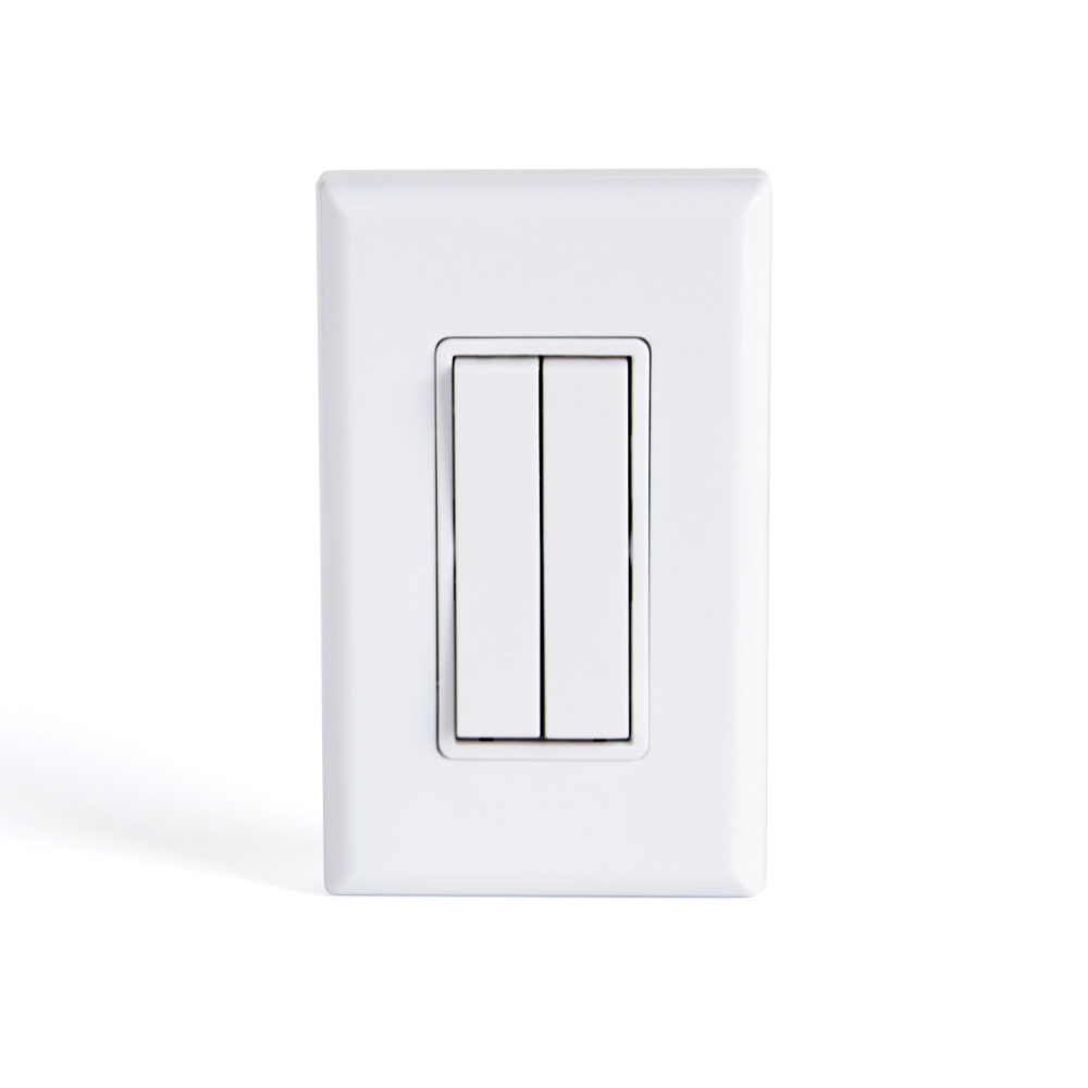

In the US or the UK, you can get either battery operated switches or kinetic energy switches which don’t use batteries but also are not wired to the Mains.
The kinetic switches either look like a traditional rocker or like a split rocker which gives you four buttons. Or two separate on/off/dimming switches. So just as an example, you could use the left side switch just for the over the sink lights, and the right side switch for all the lights in the room.
