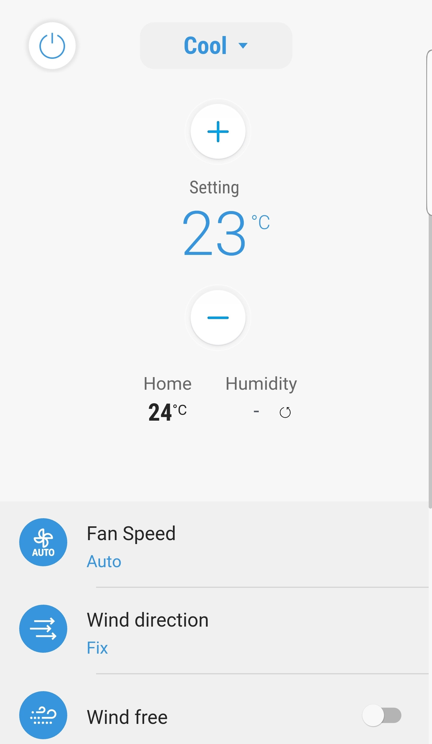

As a test, I setup runEvery1Minute(updateCacti) to make it send the readings every minute, instead of only when they ‘change’. However, this still had the same results. The temperature was always working fine and updating immediately, but the humidity is stale until i push the ‘refresh’ button on this page:
As you can see, by default when you open it, the humidity is just “-” which says to me that it’s not being polled until i push the refresh. I have no idea why they would make this different to the temperature (which is always realtime when you view it).
So if this is the issue, how can i trigger this ‘refresh’ myself do you think?

Till you see a humidity value displayed by the DTH, nothing will happen at your smartapp level. I believe your updateCacti is just looping on the units and get values of them then send that to your http server.
So as you have “-” for the humidity, getting the value of this measure can only return the same.
