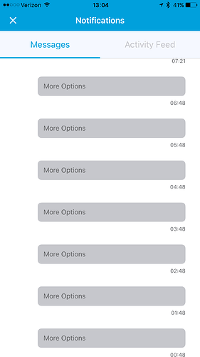

Every hour, I’m getting a ‘More Options’ message in my ST notifications. Like this:
Any ideas?
You can probably track it down a bit under the IDE. If you go to https://graph.api.smartthings.com/location/list then click ‘notifications’ then click the ID of one of the ‘More Options’ messages you should be able to see the source installedSmartAppId. I don’t know of an easy way to see the list of all SmartApp IDs other than going to https://graph.api.smartthings.com/location/list then click ‘smartapps’ and checking each one (at the bottom of the popup).
Support can probably figure it out much easier or maybe someone knows the source of this message.
That did it! Thank you!
It was the recently (to me) installed SmartThings Severe Weather Alert app. It must have been checking every hour. I don’t really need the app much since I get weather alerts from several iPhone weather apps and from my FrontPoint security system too. I deleted the app and I’ll wait an hour or two to double-check, but that should solve the mysterious hourly notifications.
