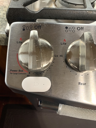

Hey Guys. It happened to me when I left one of the gas burners lit and went for a game. Luckily my daughter was at home and we caught it early. And it made me think all night and came up with this simple solution, I have put it on one burner but will expand soon.
I used a Xiaomi door sensor to find it the knob is at off position and as it rotates put the magnet off limit and opens the sensor. I am monitoring that with a smartthings security custom application.
The main sensor is just at the bottom of the knob and I used a round earth magnet and pasted it inside the knob See two photos below
This is how it looks.
