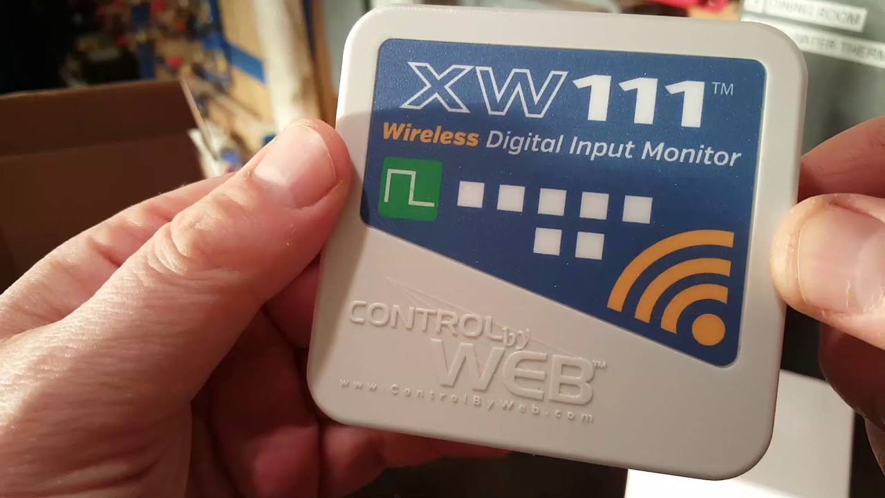

Yes, I did that exactly see my video, I changed to the Proteus sensor,
You also can use a simple relay and have proteus delay the text until your wifi has rebooted.
se my other video on the Proteus, I cant link it.
