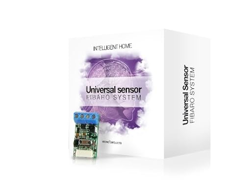

I have also found a Fibaro module which looks promising and wouldn’t need much modifying
