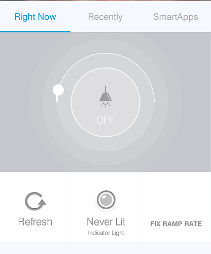

For anyone interested, I took what @chrisdrackett and @pablo did and added a tile (button) for the device type called ‘Fix ramp rate’ to decouple it from the led on/off mode. It’s just a simple button for the device that speeds up the ramp time. Like others have mentioned it just speeds the fade in/out, it doesn’t eliminate it. Here’s the code:
/pajaroblanco/SmartThingsPublic/blob/master/devicetypes/pajaroblanco/enhanced-dimmer-switch/enhanced-dimmer-switch.groovy
(Had to split the link since the forum wouldn’t let me post “more than two links” ???)

Hi @pajaroblanco. I’ve installed your device type and I think it’s working. But I’m confused on how the Fix Ramp Rate button works.
By pressing it does it change the ramp rate in increments? I get no feedback when I push it. Thanks.
@ultrazero, Yeah it’s not that clear. You only need to click it once to speed up the ramp rates. There is no feedback. It would be good to light the button or something to let you know it completed. It could also use a button to reverse it but I just took what others did and applied it to a separate button.
