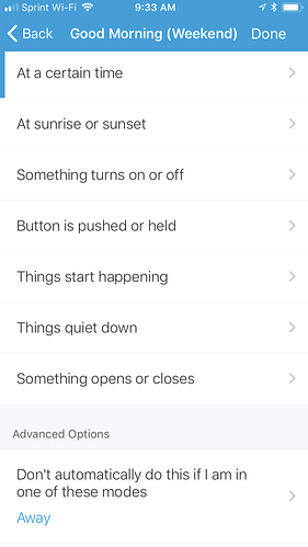

In my Morning disarm routine, I just tell smart home to disarm at a certain time when not in one of the two modes.

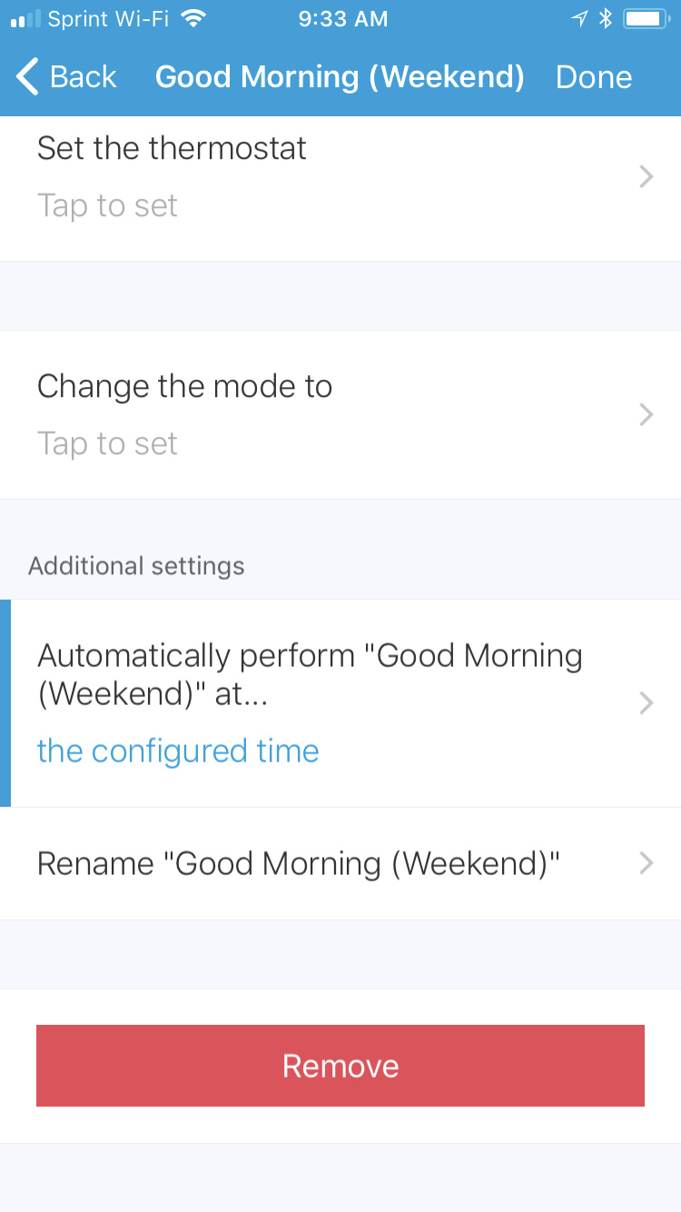

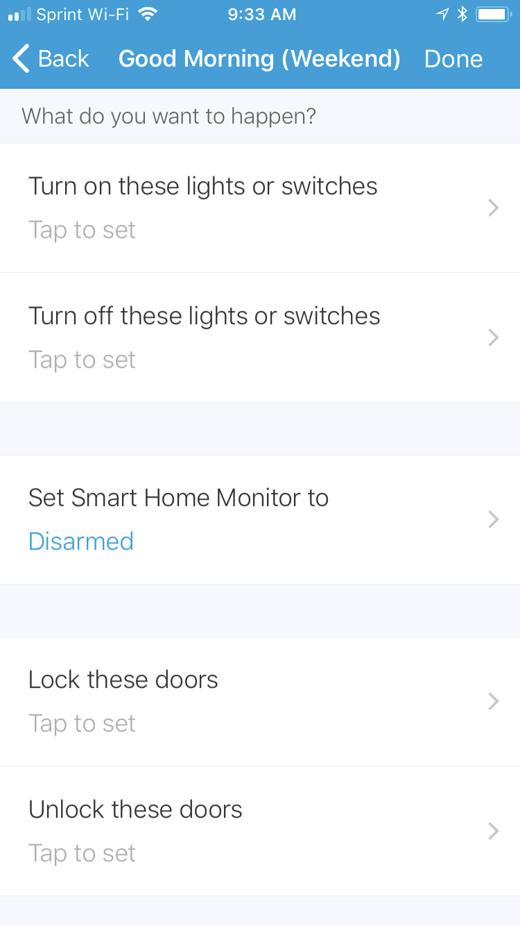

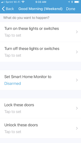

The screenshots I’m posting are for the following Routines:
That part looks OK as long as you only want the disarm to work on Saturday and Sunday.
Did you check to make sure that the house was actually in home mowed before it was time for the routine to run?
I ask because recently there have been some problems with presence.
Also, I would definitely report this to support, because it does look like everything is set up right based on the screenshots you have.

If you set it up last night and the mode was “away” then, yes, there wouldn’t have been anything to change the mode to Home before the routine ran this morning.
You can check which mode your hub is in by tapping on the “more” tab with the hamburger icon in the lower right of the mobile app screen. Then you should see the current mode at the top of that screen.
Thanks! Looks like the modes are properly set now
