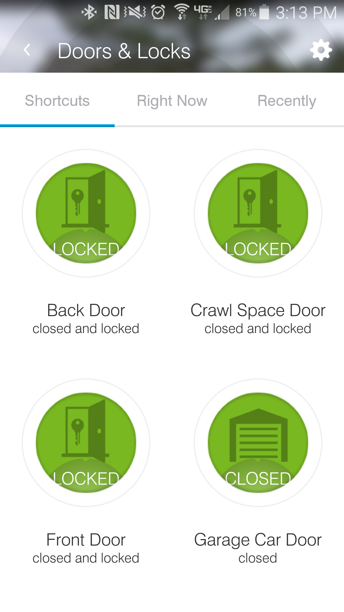

If you’re lucky enough to have the old Doors & Locks dashboard, this device type will allow you to have the door control enabled in that dashboard:

The old dashboard I think is something ST needs to bring back, or at least add something into all that empty space left over under Smart Home Monitor. Unfortunately, there’s nothing users can do to get those dashboards installed.

The old dashboards aren’t available anymore. It doesn’t matter what kind of phone you have. Unfortunately, nobody knows if the old dashboard will ever return.
