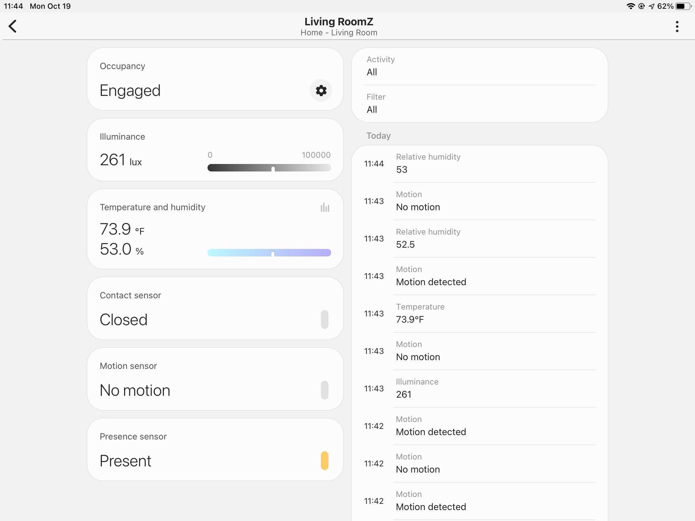

contact sensor added … this one combines doors and/or window contacts from settings.
think these are about all the capabilities i am going to display for the rooms occupancy device … at least for now … if i am missing something that’s must have … within the new app possibilities … LMK.
need to get the manual action working for the occupancy capability :frowning:
that the occupancy card is listed first is pure chance … still see no way of managing card sequencing. and that ST is wasting all this space in full width cards makes no sense to me … at the very least they could support half width cards as well … but what do i know …

this is what it looks like right now … i combined 2 images because the cards don’t fit on a single screen.
waiting on a few things from ST:
  1. support for character and font settings on the cards
  2. support for multiple attributes within a capability and presentation for it
  3. support for conditionally hiding cards. like in this room there is no power meter so that card shouldn’t even show but that is not supported yet
there is no current ETA for these features so going to stop here for now and do a private release.
mini rant: why do those lux, temperature and humidity and power meter need those sliders? look at the lux card for example. it has a range of 0 to 100,000 with a value of 202 lux and the marker is at the half way point!?! that’s helpful.
instead of wasting screen real estate they should add an option for half width cards. fit a lot more information on the screen and be viewable at a glance without scrolling. that’s a better UX.
ST are you listening?
