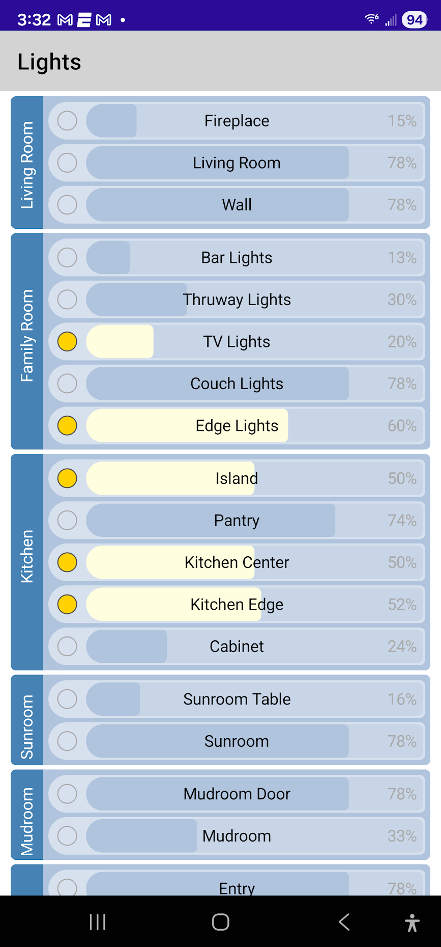

Actually, yes, I have looked. The problem is that I have 60 lights and every app I’ve looked at has a dashboard that does not scale well. To dim a light you have to scroll around to find the light, then select it to get to the dimmer settings. I need an app that passes the “Mom” test and thus far none have.

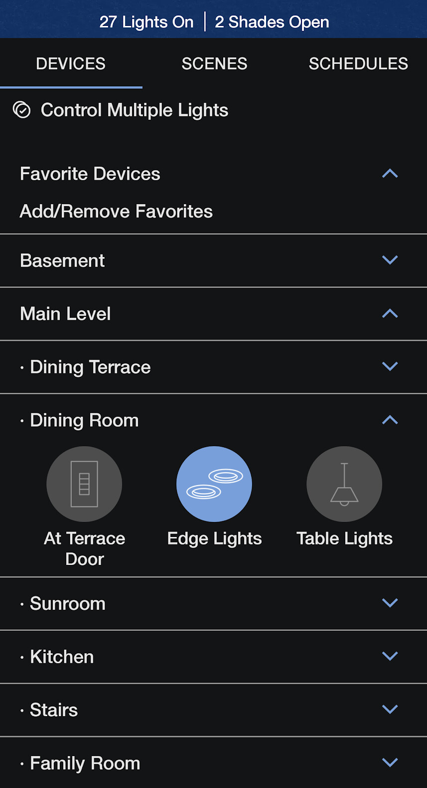

As some background, I have a Lutron Homework QSX system. They have an their own app, but again, it’s awful when you have multiple rooms and lights. Even worse, they have an API called LEAP, but it’s not accessible to end users so I’m automating Lutron with SmartThings, or trying to.
Lutron app… try navigating this to dim several of the 27 lights on in my house.
My app, so far, is simpler:
