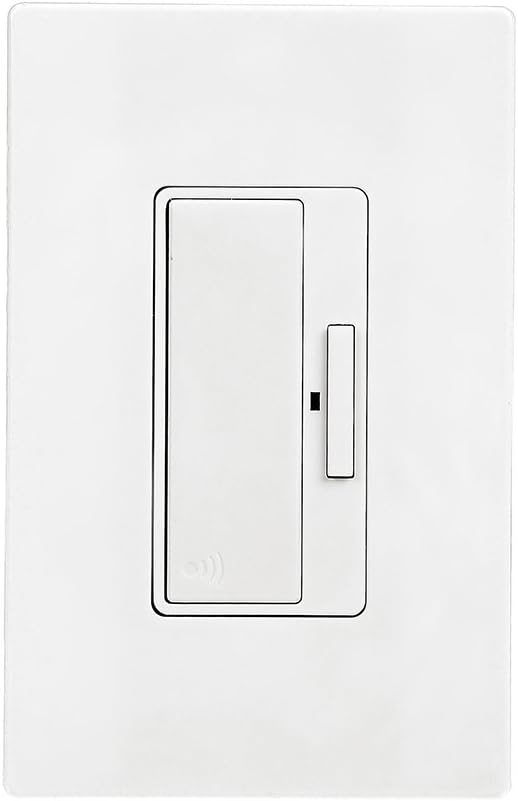

  1. The main device which is designed for this purpose is the Eaton Cooper anyplace switch. It’s a zwave battery operated device which looks just like the regular mains powered switches. (The company is Eaton, the division is Cooper, and the model line is aspire. It may be sold under any of these names.) it’s on the official compatibility list. :sunglasses:
https://www.smartthings.com/products/eaton-z-wave-battery-operated-switchdimmer
It comes in two different styles and several different colors.
https://www.amazon.com/EATON-RF9500WS-ASPIRE-Battery-Operated/dp/B004I6S0LS

It’s technically not discontinued, but it hasn’t been updated for zwave plus, either. So probably EOL. Also, I don’t know if there’s anyone working on keeping it up-to-date with the new platform changes. So I’m reluctant to recommend it at this time.
RF9575
It is a multi level switch so it should be able to control dimmers. But it’s also the older generation, so the same issues apply as the 9500.
Also, There are a few suppliers that do still have the 9500 and the 9575 in stock if you are looking for these. Check return policies carefully, though, many of these companies will only accept returns on defective items.
Again, I’m not recommending this for new users at this time, but if somebody already has some of these and likes them and wants to get more, they are still available.
I just checked and Gordon does have both of them in stock at a reasonable price but with returns limited to defective products. They are an authorized Eaton seller.
