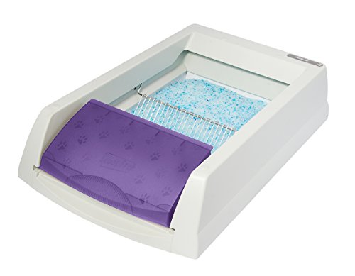

I’m wondering if part of the problem is because I’m using a different litter box – here’s the picture on Amazon:
Half of the open/close sensor is mounted on purple hatch, while the other is on the white frame. As a result, the closed/open/closed cycle happens in about 25 seconds. This is enough for the open/close contact sensor to see the activity, but perhaps there’s something about the SmartApp that doesn’t track events this quickly…?
