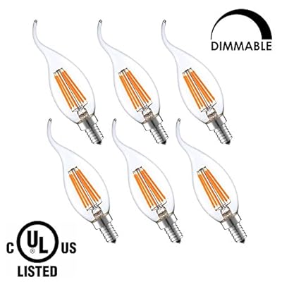

Also, I’ve got fixtures with 20 x 6w bulbs, so the total draw would be 120w at full power -but they still glow at 15-20% with the switch turned off. The smallest fixtures I have are 8 bulbs, so that’s still 40w and they glow as well.
Also, the other bulbs you recommended are exactly what I don’t want. They heat sink on that encapsulates the bottom half of those bulbs looks ridiculous when you put them in an antique fixture in an old, historic building.
These are the ones I’m using now and they look wonderful -my switches just won’t turn them off…
I have exactly the same problem with a Leviton dimmer I got from Home Depot. The dimmer is supposed to work for LEDs, and the LED bulbs I got from Amazon are supposed to be dimmable. When a switch is OFF it should be OFF with not voltage across the bulb. My chandelier has 8 LED bulbs similar to the ones you posted.
