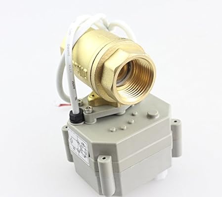

You are much better off with this (brass or stainless) if you’re going the DIY way:
This valve has the manual override AND the sensor. It looks very similar to the one I bought (and cheaper), and I use a single MimoLite relay (in latched mode) to control it and to get the sensor open/close state in a single device handler, including a single power supply that controls both the Mimolite and valve. It’s always in a normally open position, and has been rock solid.
Hi John, if you don’t mind can you share schematics how you’ve connected the valve with mimolite and valve power supply. I have the same setup, but I cannot make it work. It start closing, and then after 5 seconds opens it again. And also which device handler are you using (type)? Thanks!
