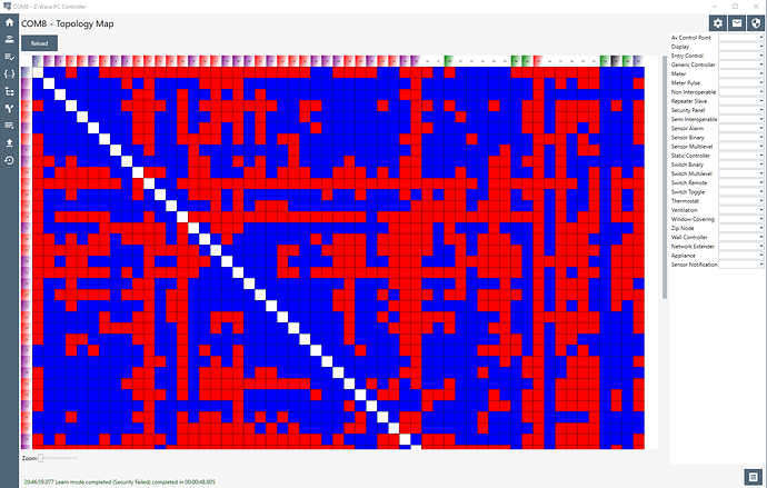

The information that you get from smartthings on zwave routing is not a topology map like most of zwave controllers would give you. That would look like this:

I have the software to see the topology map you show above, but one thing that is not clear to me is whether the map I see is specific to the controller I am using or the main controller. In other words, I have to add a Zwave secondary (?) controller to my network in order to get the map to populate. IS the map I am getting the map used by the ST controller, or is it the map used on the secondary controller used by the software? I believe it is the latter so, while interesting, it has limited value when trying to figure out what issues are occurring on the ST zwave mesh network. Am I off?

The map should be the one used by the smartthings controller at the time that your secondary controller joined the network. It won’t keep up with new devices added after that, but the map is owned by the primary.
