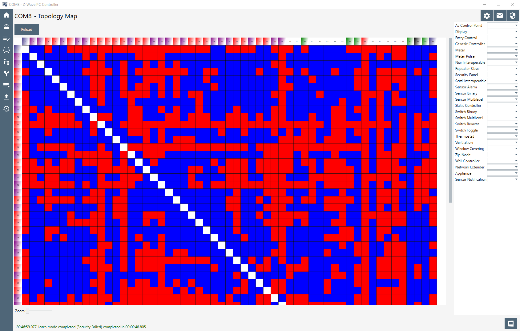

Like @JDRoberts’ post mentions, that’s just a snapshot of the last known route at the point in time the hub talked to the device. REAL Zwave routing is a mesh and looks like that screenshot in his post. It can talk to ANY of the neighbors it has in its routing table. To get that info you’ll need some specialized software and a ZStick. A lot of people see the info on the IDE and say “hey, it’s not going where I think it should” and frantically start trying to do things to force the route - not knowing that no matter what it says there, it can take any number of routes to get to the hub - and that one listed is just the last one, which was based on any number of environmental conditions at the time the communication happened. All that to say, it’s only useful IF your ZWave device is not communicating / shows up as a failure in a ZWave Repair log. Otherwise just ignore it.
