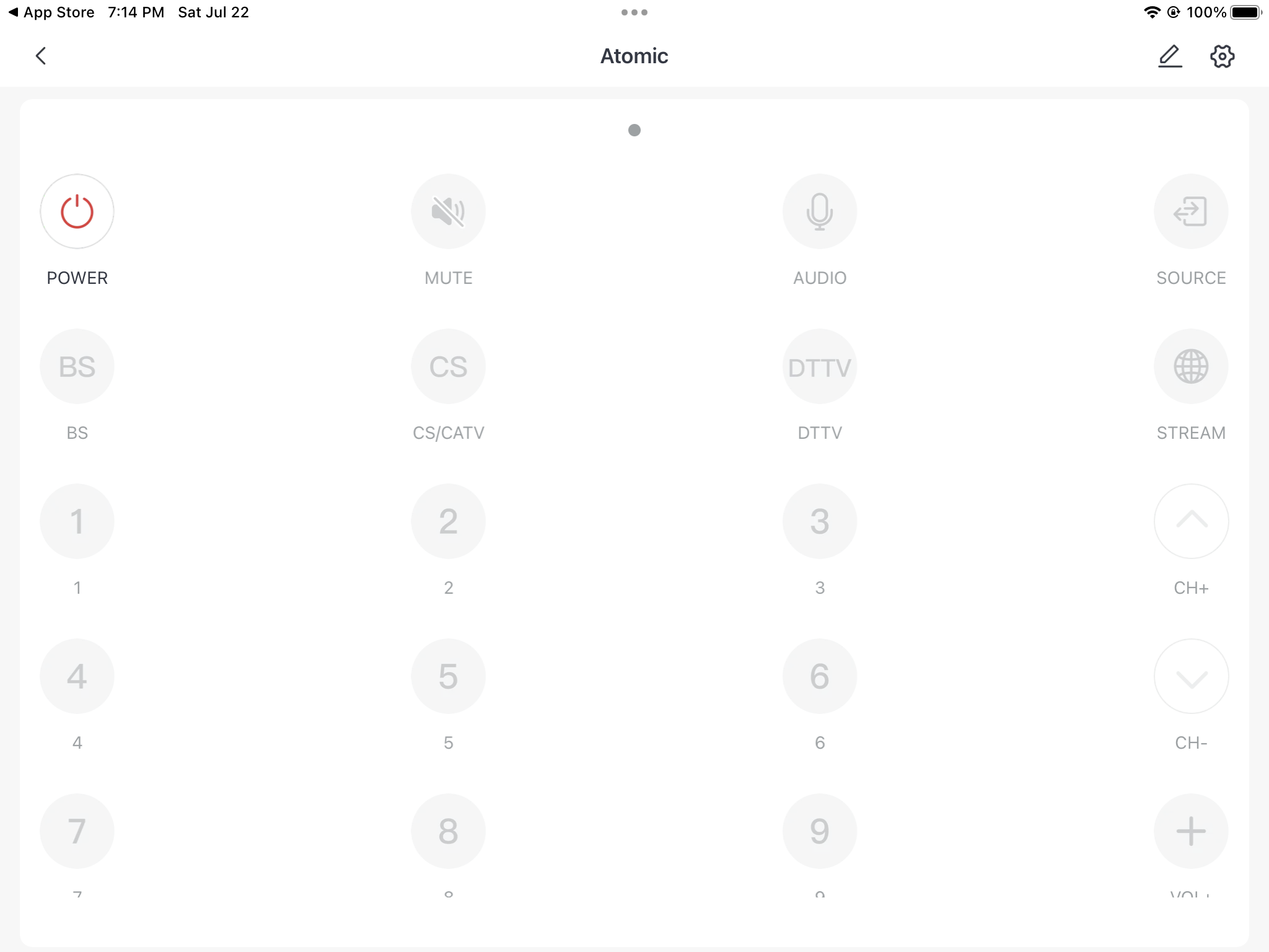

Just stumbled across this & thought I’d offer my 2 cents. I think SwitchBot IR feature was intended more for appliances. That being said Harmony although not being churned out by Logitech anymore is still supported to a degree. I just received an update to the app not more than 3 months ago. I think Harmony Hubs are going to continue to work for quite a while. Also BroadLink has been making universal remote hubs for years & are a solid option that’s more than affordable. It’s not supported by ST but is supported by Google Home. BroadLink is the way I would go if I needed an IR hub/blaster at this point. As it is my Harmony Hubs work great & have never really needed to use my SwitchBot as a remote.
Switchbot’s IR feature is definitely designed to be an app that replaces a tv remote, and it works quite well for that with its own app. The learn feature is decent and you can map any buttons. However, that functionality just isn’t included in the smartthings integration: you’re pretty much limited to scenes.
In the Switchbot app:
Same device in the SmartThings app:
So, yeah, definitely not the best TV control option if you want to integrate with smartthings. :thinking:
