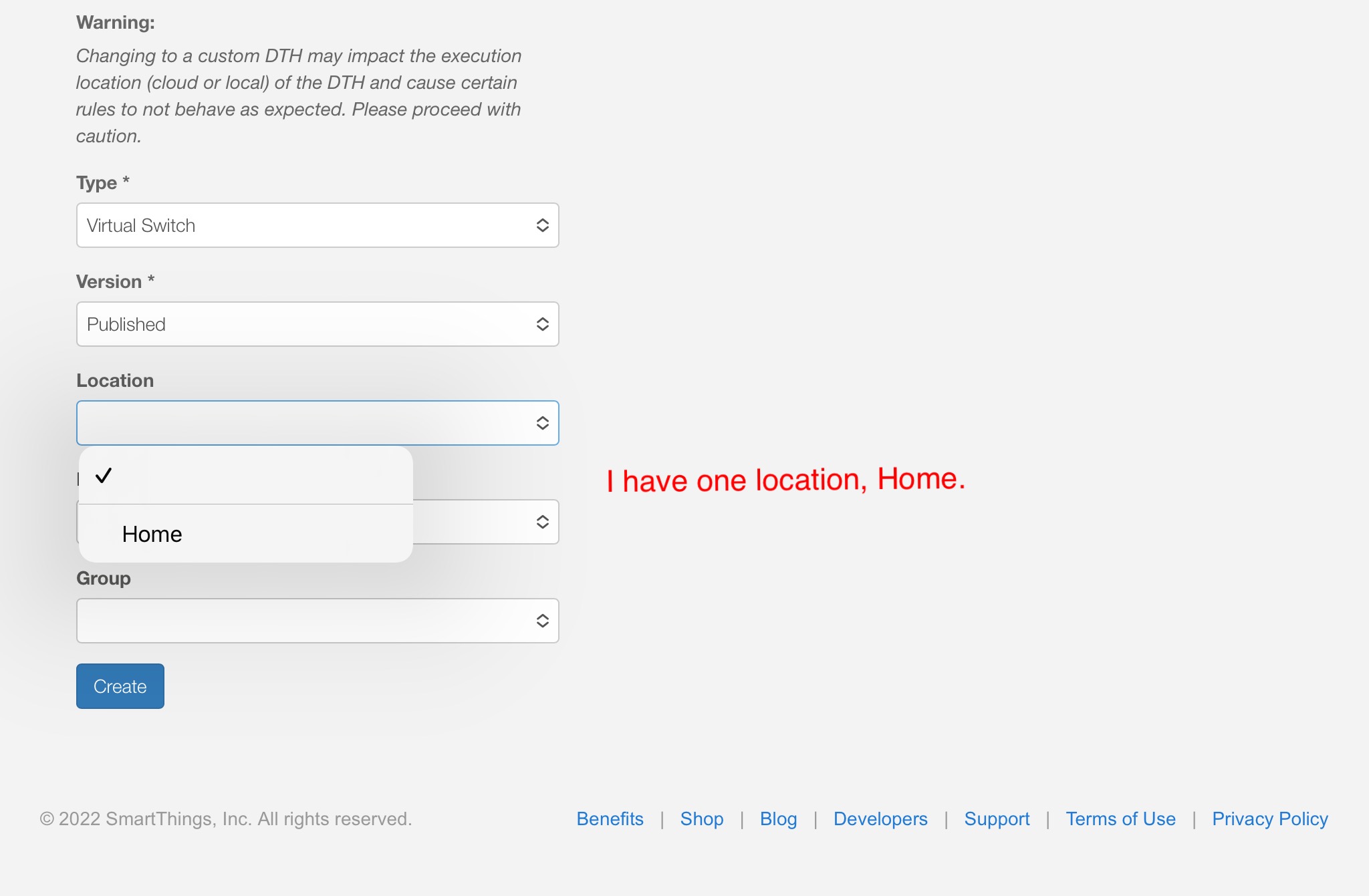

Is possible that you have multiple locations? Click on the house in the upper left corner on the favorites page. It should open and show all locations.
I think that was the problem. “Home” does not appear in the drop down when I built the switch. So I created a location and named it what one of my rooms were. I think that is why it isn’t working because it’s 2 locations. I hadn’t realized that location and the rooms were different. The drop down list when your creating the switch is blank and you can’t type into it. Why it doesn’t appear I have no idea. No hub shows up either. It’s not that big of a deal. I wanted to run an Alexa routine when the tv turns on. I can still have the lights dim when the tv comes on. They just don’t fade slowly like the Alexa routine. I can still tell her to do it, but I’m not fond of voice commands
Your hub will only show in one location and that is the one it belongs to.
You could delete the virtual switch in wrong location and recreate it in the right location.

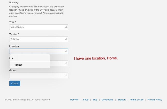

That’s what I was trying to explain. When creating the Switch it asks for a location. It will not let you type into the drop down box. I go to Locations and it has Home in it. Home has all my devices, but it does not appear in the drop down on the device page. I have no idea how to get that Switch into home when I create it. Maybe there is someway of renaming it or something so that it appears in the drop down.

You aren’t supposed to type into that box. When you tap on The little arrows on the far right of that box, you should see a list of all the locations you have created. It’s kind of a weird list because there’s a checkmark at the top of it that looks like it’s on a blank line, but it’s actually trying to tell you that you have to check the location that you want to use. By tapping the name of that location.
That’s what I was trying to say. The Box was Blank. Clicking on the arrow did nothing, just a blank box. But I solved that. I went into the Location settings, chose HOME and did an update without changing anything. HOME now appears in the drop down in the Device page. I’m going to clear everything and redo just so everything is in synch. I’ll let you know how I come out. Not sure if I’ll have time this evening. I appreciate the help.
Just to let you know the Simulated switch is now working just great. The location was the problem. Why home didn’t appear on the device page I have no idea. I originally thought it was because it was the TV Hub and not the full hub. Updating did the trick. Now the TV state triggers my Hue Scenes thru Alexa. Thanks for your help.
