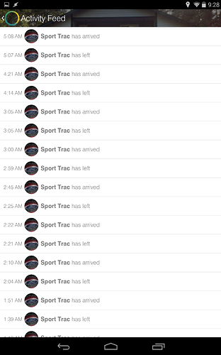

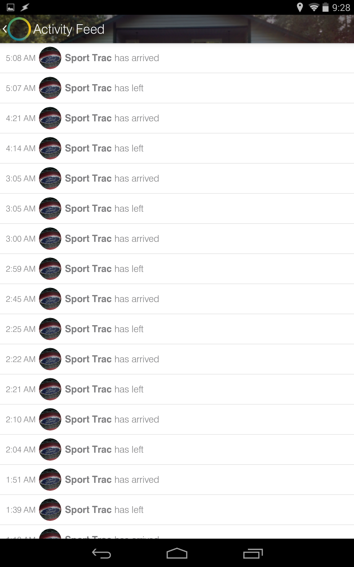

It is mounted on the sun visor in my truck. The hub is located in a bedroom directly above the garage (I estimate the distance to be 16 feet from the hub to the fob). Oddly, it seems to always happen in the early morning.
It is probably on the edge of the network and is coming in and out. There is a way to change the timeout on the presence tag to avoid this.

Curious that I only have seen this in the early morning when there is no activity on the network other than the multi sensor’s (mounted on garage door) temp broadcasts.

I have only had the thing since Thursday, but yes… except for today when I put it in the room with the hub. No false triggers since then. What’s weird is that there is a multisensor on the garage door that never fails, shouldn’t it be relaying the signal of the fob, or does the multisensor not do that?
@scottinpollock only powered devices relay signal. The multi probably isn’t having any issues because it has a power amplified radio.

Before Support replaced my tags, they would begin “leaving” and “arriving” constantly around 8:30 PM CST and finally end around 9:45 PM CST. The new tags received are more sporadic, but haven’t acted up since last Thursday (6/5).
Happy to report that since putting a USB powered motion detector in the garage, I have seen no more false alarms from this thing.
