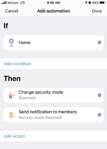

Btw, here’s the compromise for automating STHM disarm. It automatically adds a notification to the automation. Then you can choose to keep the notification or delete it.

Can you explain this a little more.
I use SHM in classic. Are you saying that if you change the mode to Armed in webcore it will Arm it in the new app as well?
No, SHM in Classic and STHM are still two completely separate apps. So changing arm/disarm in one does not change in the other. Also, at this point, webcore can not control STHM in the new app.
But one thing you can do. Locations such as home, evening and night are synced between the two apps. If webcore is changing those, you can create custom automations in the new app that when location changes, you can now change STHM.
