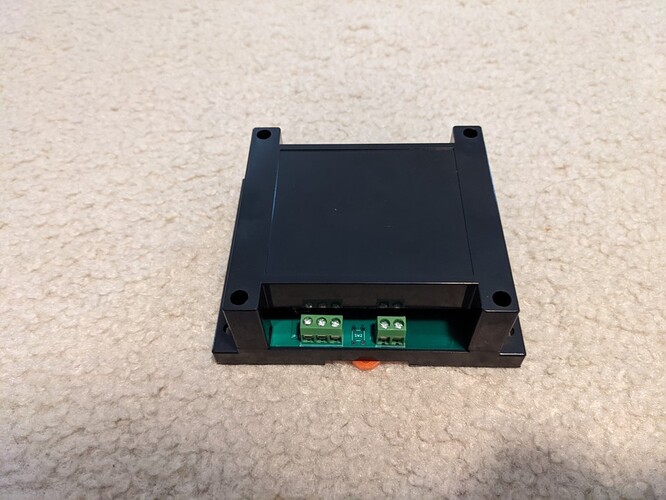

In one case, I am able to replace the power by energy harvesting. The battery is needed for a backup only. Here is the first device that I make. It is an Fireplace smart controller.

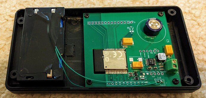

Another device that I make is a gas stove sensor. This is an example where the battery is the primary source. As the sensor detect the use of the gas stove, It is also harvest the energy. It is a little bit different strategy of taking advantage the harvested energy from the fireplace controller. The energy harvested can be used to add more functionality.

In this project, I use a very good MCU from Nordic Semicondutor. The power generated from the energy harvester enough to power the MCU running a full Zigbee Sleepy end device.
